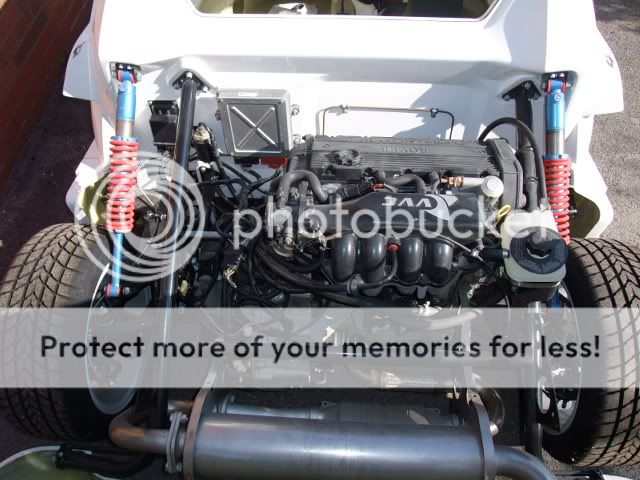

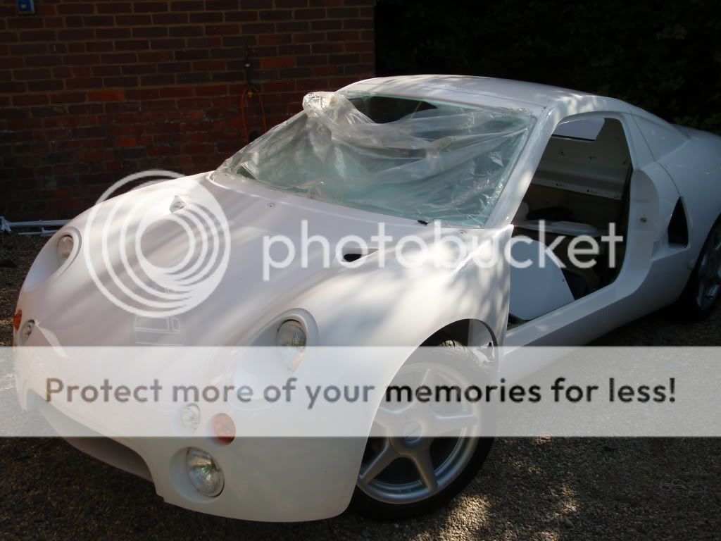

Here is another couple of pics
I am getting there slowly!
Chris

I told you all white is the right colour 8) 8)
Nice work keep it up! :D

I assume, from the pic of the Libras front end, that you intend to use a cable operated cluch. When
I was building my Libra 5 years ago I was told DO NOT fit the cable clutch, go for hydraulic operation.
I chose to ignore the advice but within a few months was looking for a hydraulic fix due to the
juddery operation of the cable system. All I can say is dont repeat my mistake.

Thanks Don,
I'm afraid the clutch is already in so I will stick with it for now and change it later if (when) it starts to judder.
Talking to Bob Snooks it looks like i will probably have to change the dampers and springs at some point too. So I will save it all up and have something fun :roll: to do next year.

Post Re: My New Libra
Looking good Chris.
I too noticed your clutch cable and was going to warn you about it, but as usual I'm too slow in posting.
I would make and carry a cable repair kit as they break as well as stretch. The nipple breaks off at the pedal.
You said at the meet you have a 1.8VVC, what gear box do you have :?:

Looking at your pictures I think I can see a PG1 gear change :?:

Not sure which Gearbox, I just assumed there was one type.
If it helps it has the mechanical gear change rather than the Cable gear change, and it looks to have a Cable drive with an electronic signal converter screwed into the drive.
I believe that it was also out of a rover 200 not an MGF with supossedly 18000 miles.
