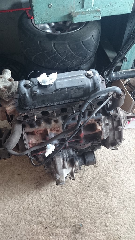

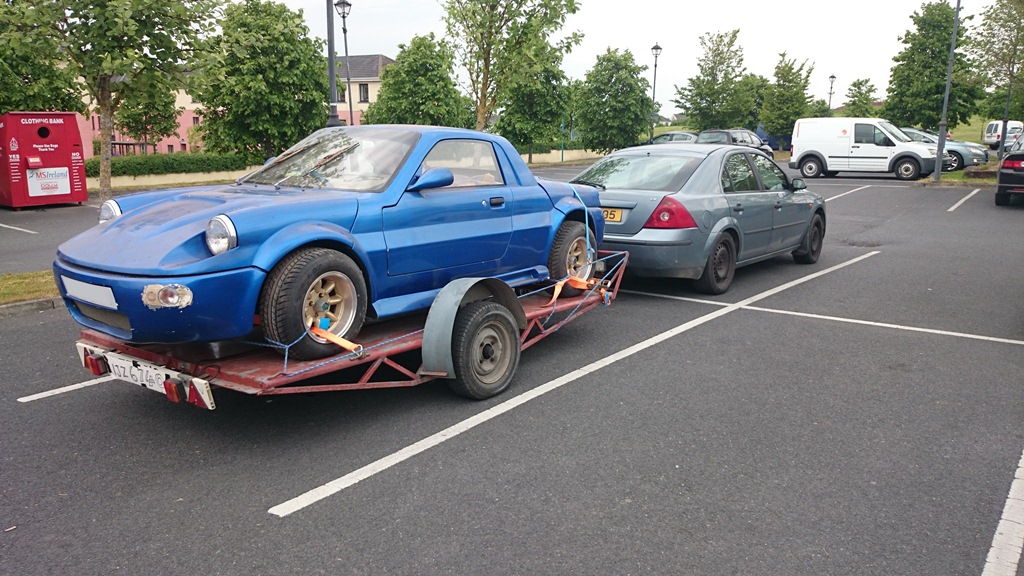

Hi Folks,

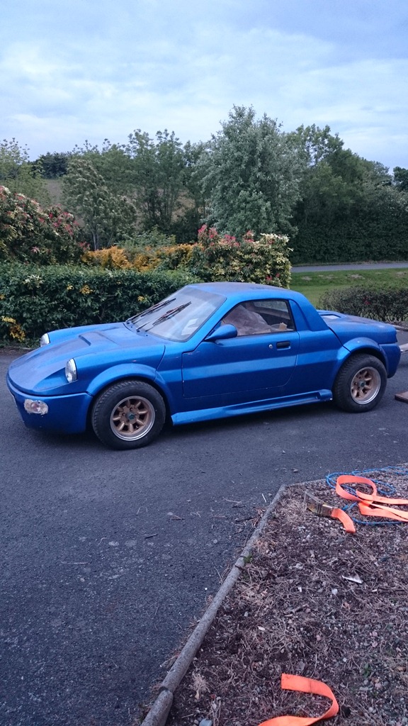

Brand new member here. Have just collected a Rossa Mk1. Hopefully a few pics below, if I can work this yoke.
The plan is for this to become a "race" car, for hillclimbing, autotesting and some navigation rallies.
I've a million house related projects on at the minute, so the build is only going to be a day a week or so, but I'll try to update this any time there is significant progress. Wanted to start a thread so I can see the progress myself, but also so the previous owner and friends can check up on it...and give me a boot when I'm slacking.
Engine with it is a standard 1275cc A Series. I can't drive anything without an LSD, so I've a few quid to invest. So the question is, do I stick with the A Series, or try something else? (I know the engine bay is tight, but if it was worth it, I'd go semi-spaceframe). Ideally looking around 160bhp, so if A Series, thinking it'd need to be a 16v conversion on fuel injection. What BHP does a "Stage 4" head with hot cam on carb(s) get, 140bhp?
Any help/advice/encouragement or good aul banter welcome,

Hi Willie & welcome
I have to say that if you wanted a Rossa with 160bhp, then a Rossa K3 would have been a better starting point! The K3's were fitted with the K-series engine, so bung a 1.8 vvc in & you have an easy 160 bhp Rossa.
But as you already have a Mk 1, i guess thats not really an option.
Although i've had lots of Mini's & Mini based kits over the years, i've not really tuned them much. But i would think getting 160bhp from an A-series is pushing the limits (of reliability!) of the engine.
There are several owners on here of coupe's, that have swapped the A-series engine for Honda units or various bike engines. But not sure if anyones fitted them to a Rossa.
Whichever way you go with your project, best of luck with it, & do post the progress on here for us to see ( with pics if poss - we like lots of photo's!!)

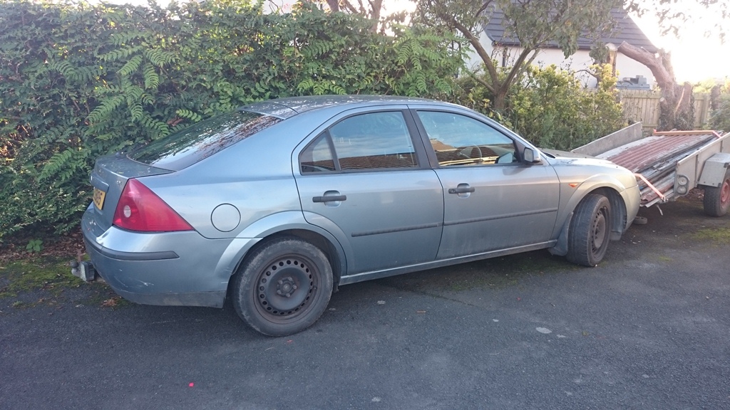

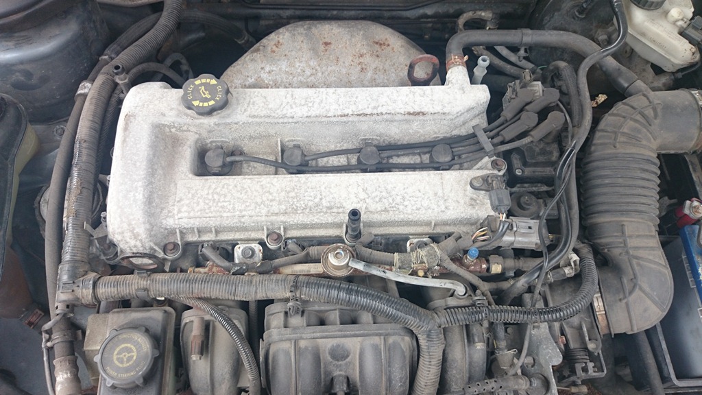

I have a 2.0ltr Duratec (Currently in the towcar - Mondeo). I bought it for the engine as it had only 52k miles on it. Runs as sweet as a nut, doesn't burn a drop of oil and pulls real strong. Last night I was measuring up with the tape. Currently I'm thinking it's the way to go. 140bhp standard, 180bhp on throttle bodies, and over 200bhp with a set of hot cams on otherwise standard internals. Now that would be fun!

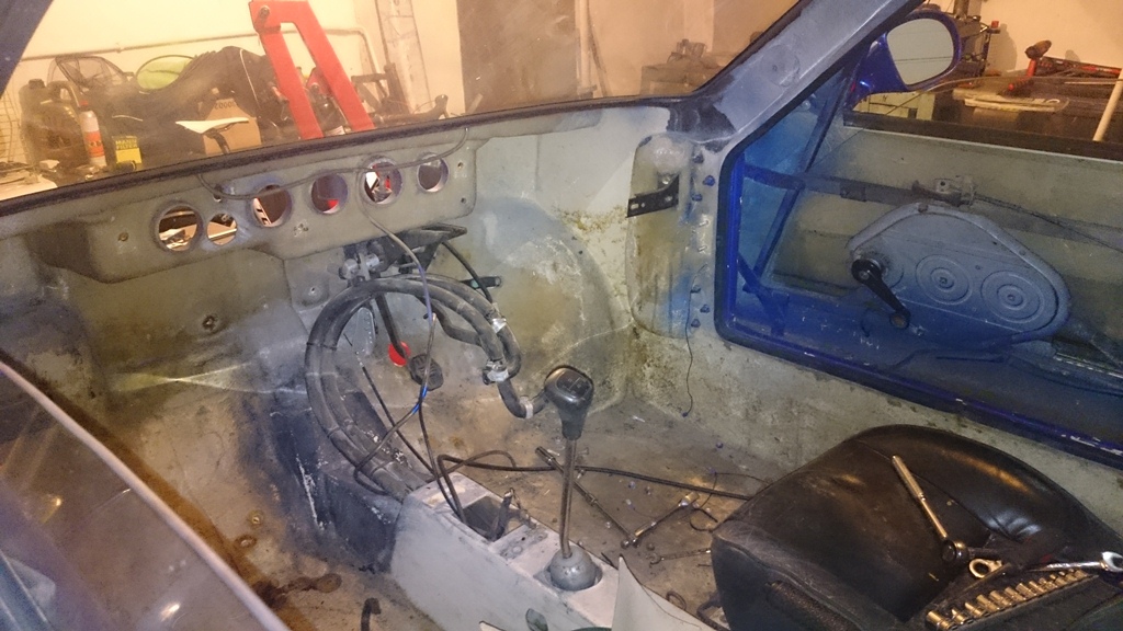

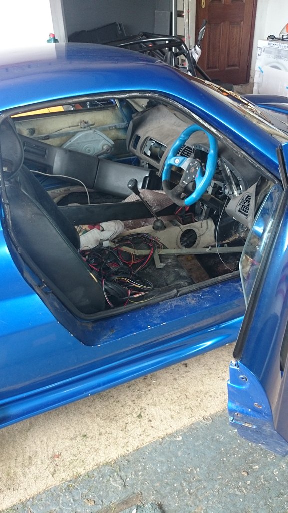

So far I've done little to it; mostly just looking and pondering. A previous owner had started to fit a MG (F I assume) dash, and lots of the interior gubbins from the MG was lying inside her. I removed all this as it's quite heavy and I just didn't like it. I'll make my own dash so I can place the instruments where I like. I was also given lots and lots of A Series spares with it, so I took those out to be stored separately.
Next job is to get it up on trestles/work table so I can take better dimensions of it. Want to get the basics drawn up in CAD, so I can examine the suspension and decide how to go.

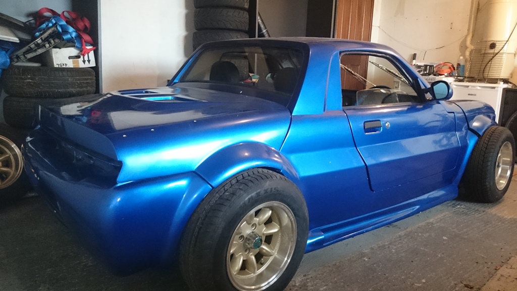

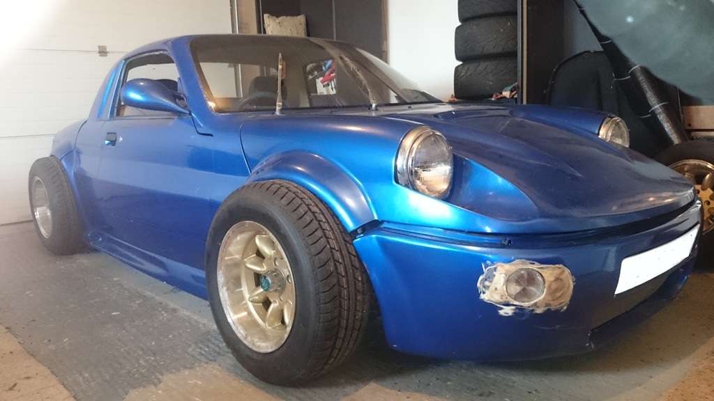

Interesting body kit on that. Have you seen Scott Masterton's thread about his spaceframed Type R build in Projects? Unfortunately, most of his photos have disappeared for some reason though. I'll be watching your progress with interest :)

The bodykit doesn't overly float my boat. Some bits have been done nicely, others not so much. I might keep the skirts, but I think the front and rear venty things will be going. That said, by the time I've finished...the bodykit will probably seem relatively tame.

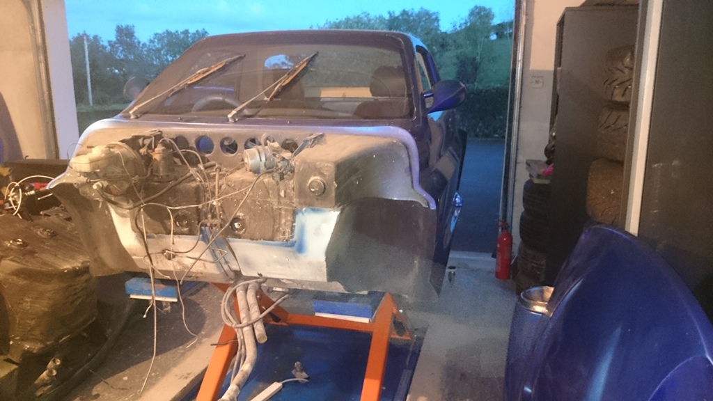

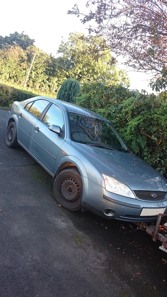

Summer has been spent doing garden and house related projects, but with winter closing it, its finally time to get at the Rossa. HURRAH.
It's still going to be slow, but I'll try to get an evening a week at it.

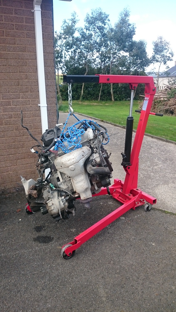

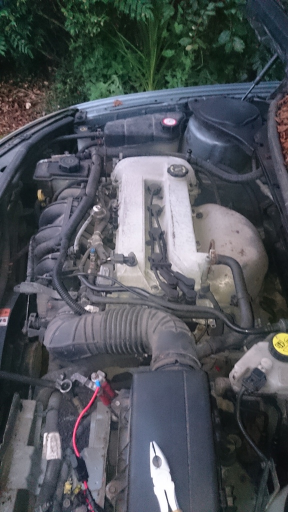

Got a good Saturday at it, so managed to strip the donor (Tow car) Mondeo of parts I reckoned I could use.
- Removed the 2.0ltr Duratec engine and gearbox
- Removed the front hubs and driveshafts
- Removed the front brake discs and callipers
- Removed the gear lever assembly
- Removed 4x gas rams (For boot and hatchback)
- Removed 4x electric window motors

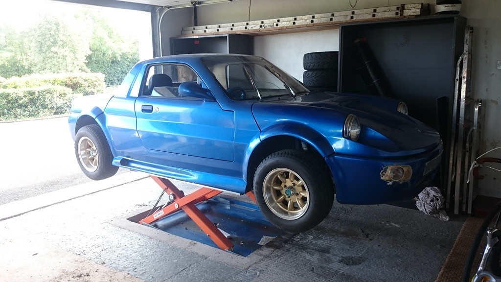

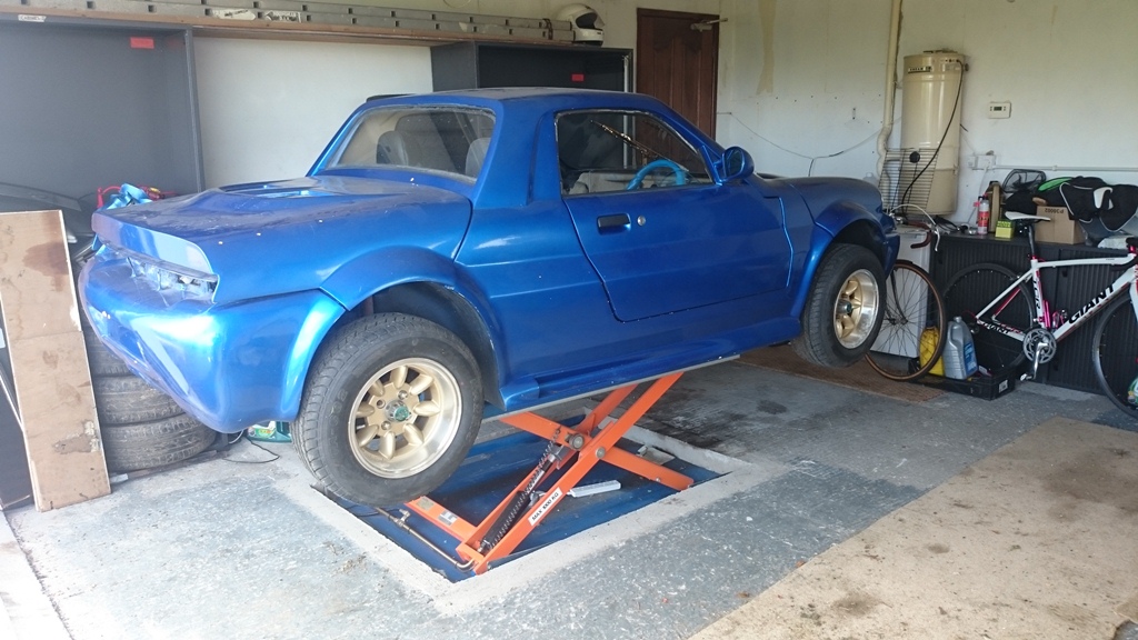

I then stuck the Rossa on my lift and pulled the wheels of it. Set it back down at approximately the ride height I reckon I'd run at for hill climbing, and then set the wheels against it.
The current track is about 60", and the Mondeo track is 68", so I set the wheels out to see what a 68" track would look like. Wide. I'll probably end up somewhere in the middle. The current wheel arches are tiny and with the current wheels on it, she already scrubs near full lock. Sitting around 4.5" ride height (Under the body) has the wheels rubbing underneath the arches. Flared arches are going to be required anyway, so I might aswell increase the track if it helps me.
Next job is to remove the rear bodywork and subframe, then swing the Duratec engine/box over to see what I'm up against.

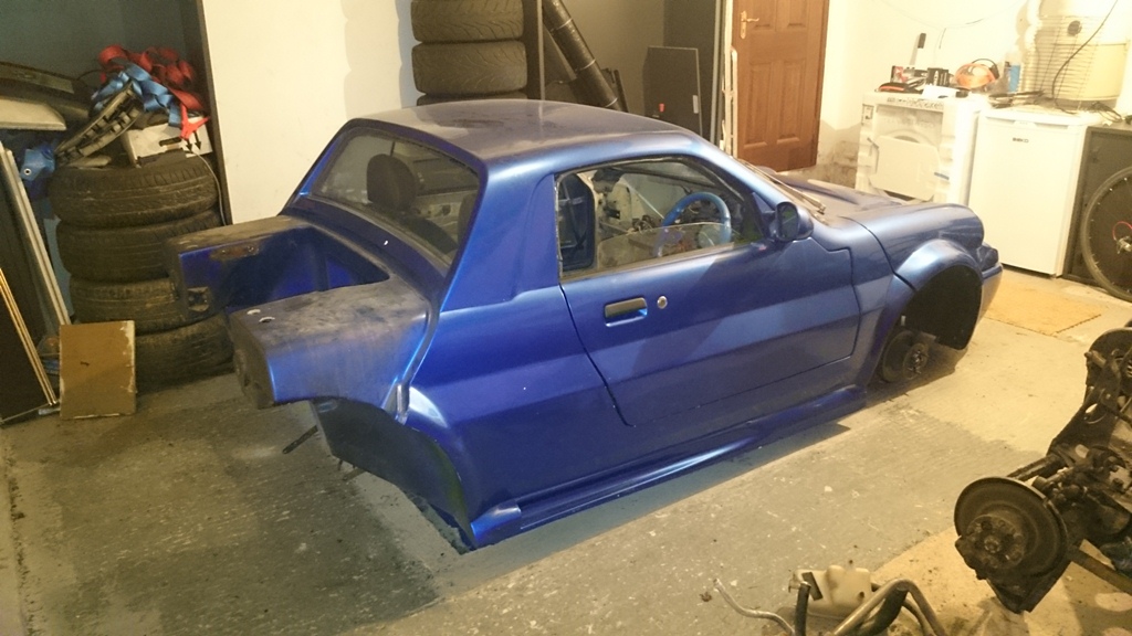

Anyway, got an hour at it last night, so lifted the boot/engine lid off. Couldn't believe the weight of that thing. It must be 25kg. I'm now wondering if the Duratec even has enough torque! Also took the boot box off, then removed the rear subframe. Still wondering why on earth the rear lid was made so heavy when it's not a structural section. I'd like to make a one piece rear end (And possibly similar at the front), which could be significantly lighter, but mainly be removed quickly for access.
Couple more pics.

Was looking forward til today all week. Finally time to get my TIG welder going for the first time. Went to collect bottle and they'd messed up stock, so it was mixed and not pure argon. Between that and other hold ups I managed to get nothing done to the Rossa at all.
Well, I wheeled the engine over to the back of it, but that's it.

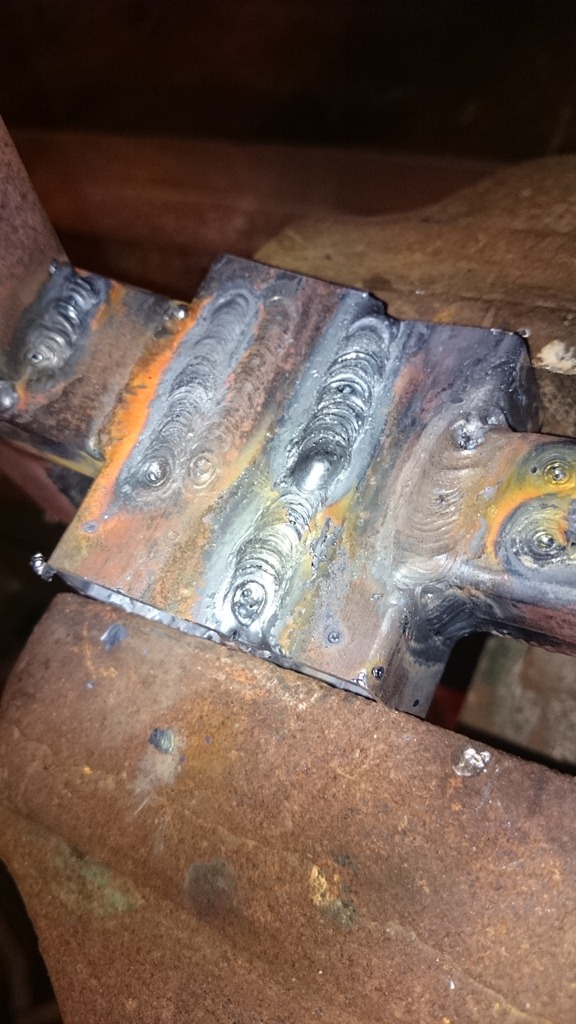

Been a frustrating couple of weeks. Obviously I'm going to be doing a lot of fabrication work (The bit I'm most excited about), but I didn't actually own my own welder. I've always used either my Da's or a good mate's Oxy Acetylene for brazing, as I've been working at their places. I love brazing and am comfortable with it; but decided to get a TIG. I needed an ARC welder for making benches/gates, so it was easy to get a TIG torch for it...and I've always fancied having a go with TIG.
All manner of hold-ups ensued. Couldn't get gas. Then could get gas, but when I drove 50mile to collect it...it wasn't the right stuff. Needed pure argon, and they'd put argon mix into stock as pure. "Grrr" I exclaimed. Then the torch was missing a collet and holder for the tungsten I really needed.
Excuses aside, I eventually got a little bit of testing/playing with the welder done. It's taking me time to re-adjust from the gas. "Torch" angle needs to be more upright and you really do need the right sized tungsten (Which was the one I couldn't use, so worked this out at the very end). Gas flow is critical, too slow and it doesn't shield. Too high and it actually seems to get dirty. I think it becomes turbulent and maybe induces a bit of air into the puddle. It also seems that if you're welding it right and penetrating right through to the other side, you get impurities. I'm not sure yet if this is air coming up through from beneath the job, or if it's just grease/dirt/rust from inside the tube.
Biggest problems are because it's a scratch start TIG. I have to touch the tungsten off the job to get the arc going. This contaminates the tungsten and you're kind beat before you've even started. Grinding the tungsten to a point helps, but I think it's something I just need to practice. I'm sure I can strike it better than I currently am if I can get a decent flick. The same problem occurs at the end when you want to finish. To stop you've to pull the torch away and break the arc. That obviously removes the shielding gas from the molten puddle, so you end with a crater. Pic attached of trial piece with various settings/styles/rods and trying to stop without the crater. I think I'll try making a foot switch to break the earth so I can stop the arc and keep the gas going.
I've a lot more practicing to do before I'm happy to do any chassis work.

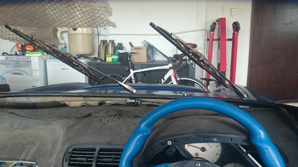

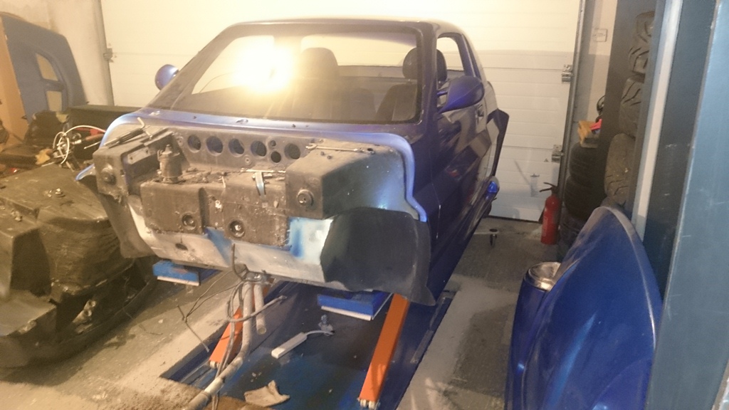

In other news, pulled the front end off, removed the dampers and soon to start removing the subframe. Can't get over how heavy all the bodypanels are.
Just a couple of pics this time:

Hi Willie I've acquired a tig set and am practicing, I have adjustable start and stop ramps to vary the current :wink: yonks ago a good welder was using this set on light gauge stainless tube and he put nitrogen inside the tubes to stop oxide forming as it was for a food factory pipe installation.
The tungstens should be ground to a point.

Glad to hear someone else is at the practicing stage! Unfortunately my TIG is a bog standard inverter unit, so no fancy stuff. I find myself wanting things though, like a burst of higher current to get it going and an arc trigger switch on the torch. Will just have to keep practicing and hope I get into the swing of it with the technical limitations. Currently I'm the bigger limiting factor.

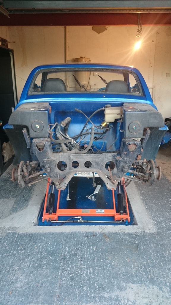

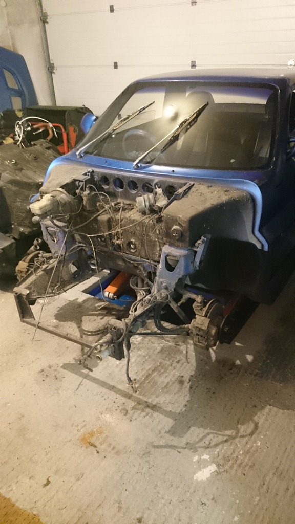

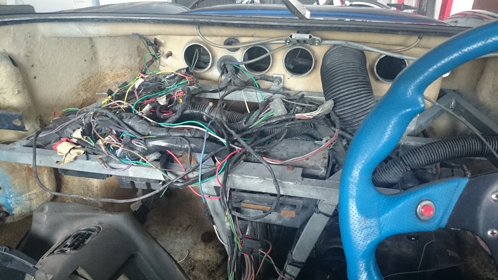

Got a bit of time last night so removed the subframe and stripped the front end down a bit. I intend to replace the dash/heater/tubular front structure with one tied in with the cage, so took it out too.
