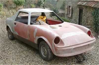

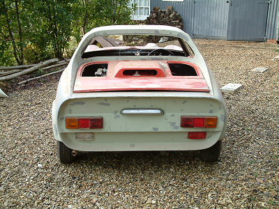

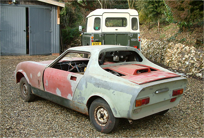

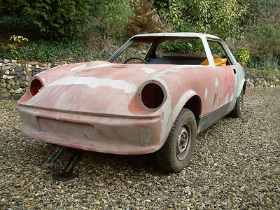

Four pictures should be attached hereabouts, fingers crossed.
Jules
To paraphrase Dino... a couple of weekends work and it'll be up and running!! :wink: :wink: :roll:
And where might this fine motor vehicle hail from? (Where'd ya live?! :) ) In case there's a friendly neighbourhood GTMOC person nearby... :)
