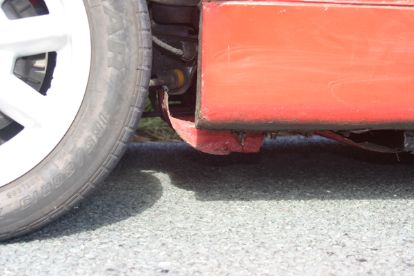

Ken, Can we see the plans for the underfloor ground effect setup please?

Post Re: Rear Air feeds
Think they came off this forum (Maybe the old one)
From what I can see, it fixed to the trailing edge of the seat dropped tray, then is shaped in a curve up to the floor, a second curve pushes the air vertical to cool the alternator and block. I guess it might send spray up to the distributor if you are still running one.
Maybe Adrian Newey could make it flex a little towards the ground at speed. :lol:

Hi This is my Coupe Q231JCP featuring the underfloor scoop. This modification cured my engine bay overheating and I do not get fuel vapourisation or any other inconvenience of that nature anymore. One or two articles have been written for the forum or the newsletter about this modification most of which is featured in the last post by Ken555 and he seems to have described the layout and function of the mod. quite well. (Well I can understand it anyway). Any further queries, please ask and I will do my best to help.
