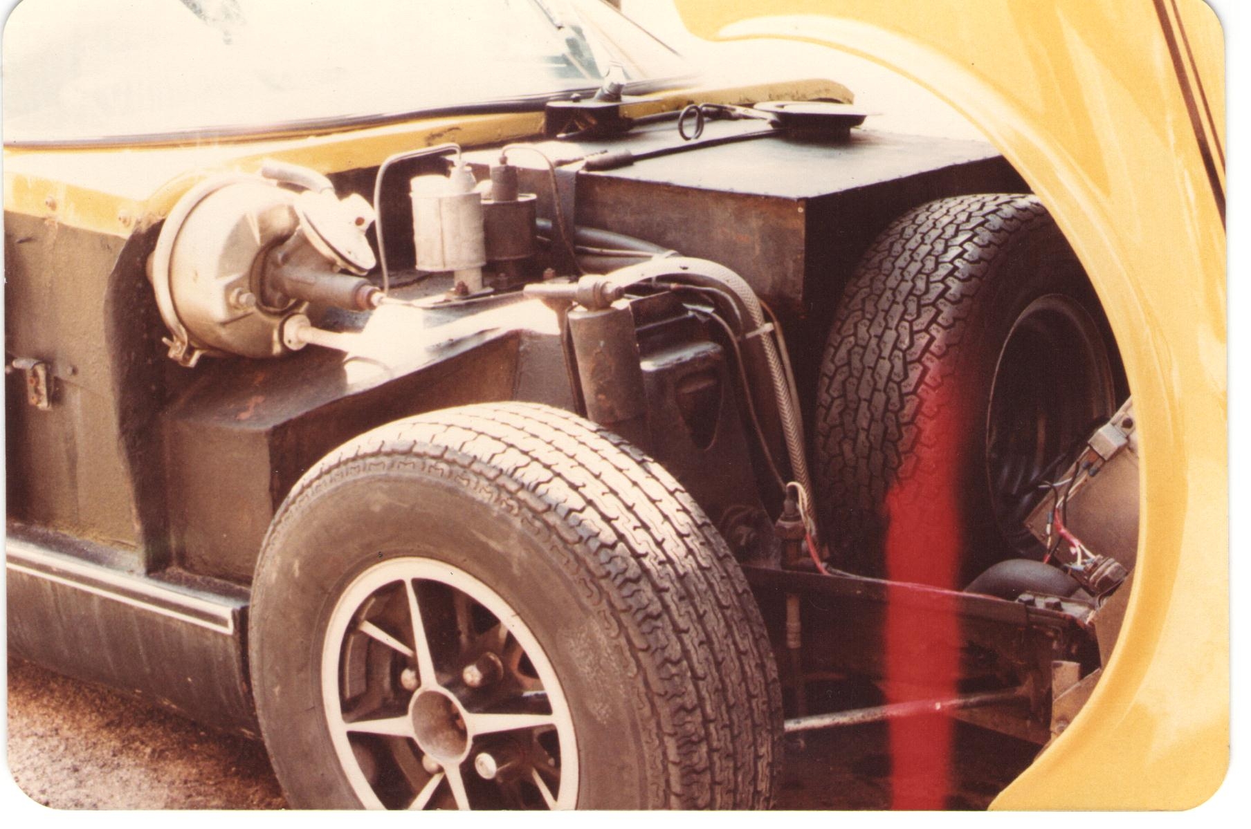

This was my old 1969 Cox which I fitted a tank into the Vee

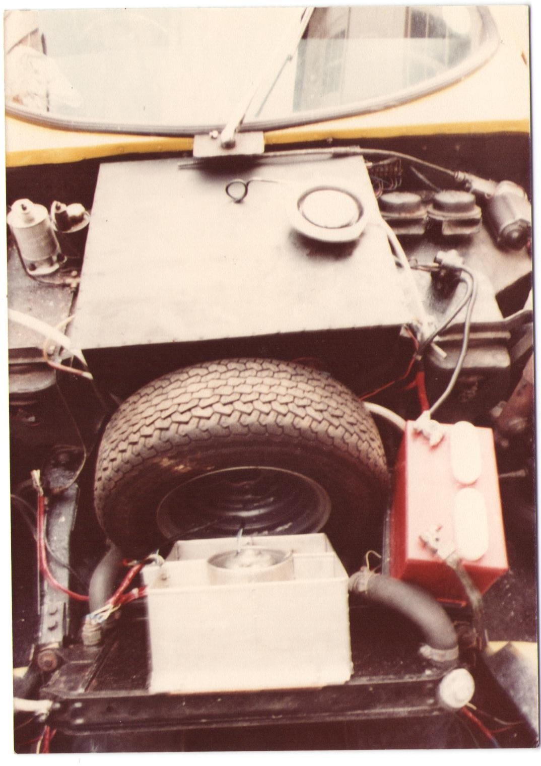

Another picture of 69 Cox
