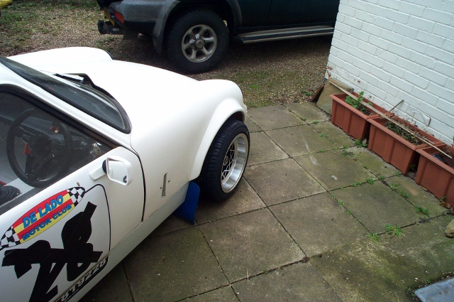

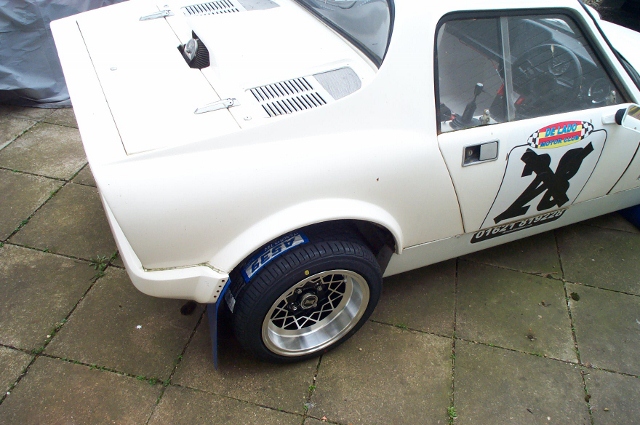

hi all any one know what offset i would need to fit 13x7 wheels under standard arches :D

Hi,
I'm not sure that you can get 7" wheels to fit under the standard arches -- attached are a couple of pics of my car trial fitted with 7" wheels with standard mini offsets (hope they've up-loaded ok) -- they would require wide group 5/6 arches for full coverage. I think that any further inset will result in major problems with back locks -- the inside edge of the tyre catching on the footwell and/or subframe on full lock -- even at this offset I suspect that a sport pack rack with travel limiters would be required. The maximum wheel width supplied by GTM was 5.5" although I think some folks have managed to fit 6".
