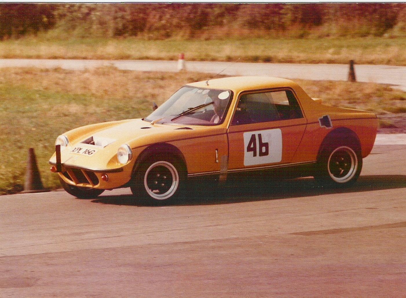

My old Cox GTM always used a front mounted radiator, in its original build form with cooking 998 and single carb a standard mini rad was fitted, when i installed a 1430 “S” engine I fitted a Renault R16 rad across the front sub frame, fully ducted with an outlet from the top of the front cover
