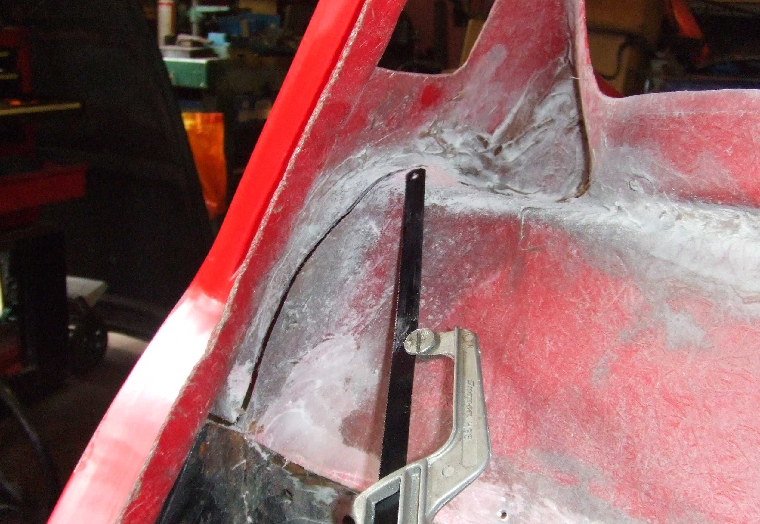

Im removing the body off my coupe today ! :idea: I have not had to touch the inner wheel arches. I made a cut up the glassed in bulkhead both sides - see picture - with a hacksaw blade in a holder. Gives enough spring to widen the body at the cill to get it past the tub. Ive cut the steel pillars at the top of the hinge mounting plate and I am going to fit a solid round insert into one end to locate the cut tube ends togeter, I will probably drill and tap them in place.
File comment: cutting the body
