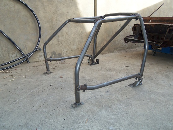

I got the cage tack welded yesterday; this morning removed the body and took the cage out to full weld.
Just a thought for those trying to comply with MSA regs requiring back stays to be fitted, it looks possible to pass a tube through the buttress down to an outrigger platform in front of the rear shock mount, when the cage and body go back on I will have a better look to see if its possible

Making good progress, be interesting to see if you can get a backstay in, get a lot of pictures!
