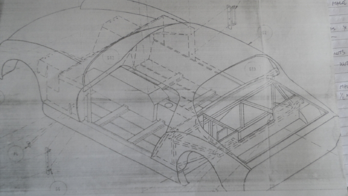

The centre tunnel is a key part of the GTM Coupe's monocoque structure.
I have seen a couple of examples where someone has cut away the closed bottom of the tunnel (to get access to the gearchange) and this has caused the tub to kink!
I dare say that it could be possible to lower a portion of the top so long as the full structure is replaced and the new part fully welded.
The 1980's general assembly drawing shows a stepped central tunnel.
My GTM Coupe has square holes in the top and sides for access to the gear change, I think these would be better if they had rounded corners.

I did a lot of work on this when I made my GRP chassis/tub.
Basically the chassis is just 3 box sections (the tunnel and two sills) connected together by 2 bulkheads and relies heavily on the tunnel for its rigidity.
Personally I would not make any modifications that weaken the tunnel in any way. It will certainly have a detrimental effect.

On my coupe I modified the panel by the wheel, instead of having it go to a sharp corner I ran a sheet across the corner that just misses the tire, then I removed the inner corner to widen the pedal area. This allowed me move the throttle pedal and brake across and away from the column. My pedals are all individually mounted so I could get the position exactly as I wanted. making enough room for my size 10-11 feet, I can even drive mine in safety shoes/boots.
Now I have considered a modification to the tunnel to allow me to move the seat over slightly which involves making the tunnel more triangular. I have some other plans brewing as well I really like the early chassis dropped front bulkhead and how this ties in the bulkhead better and would like to replicate that on my chassis one day as i feel its a better engineering solution.
If your going to do mods to the tunnel you need to be very careful with how and what you do, i.e supporting the chassis correctly while modifying.
