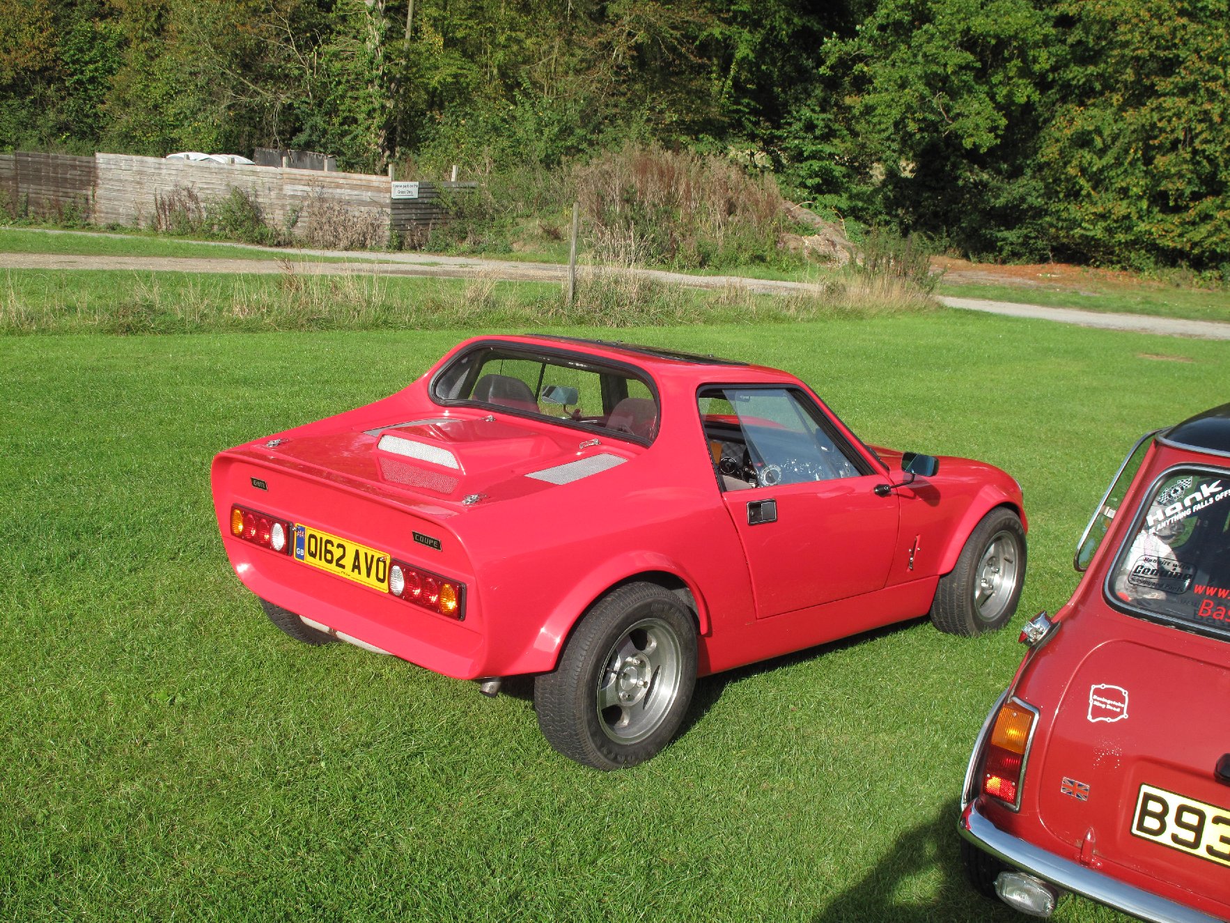

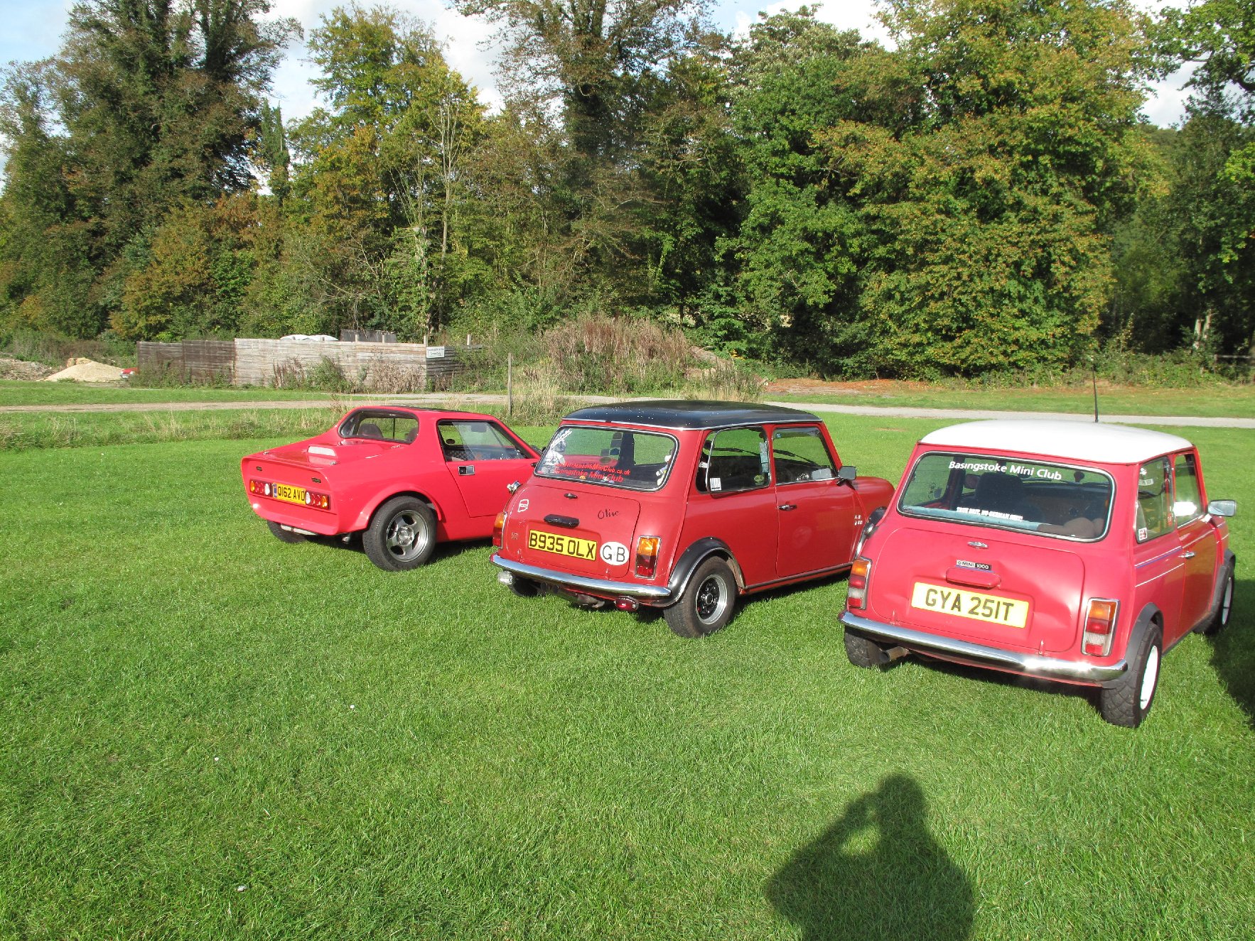

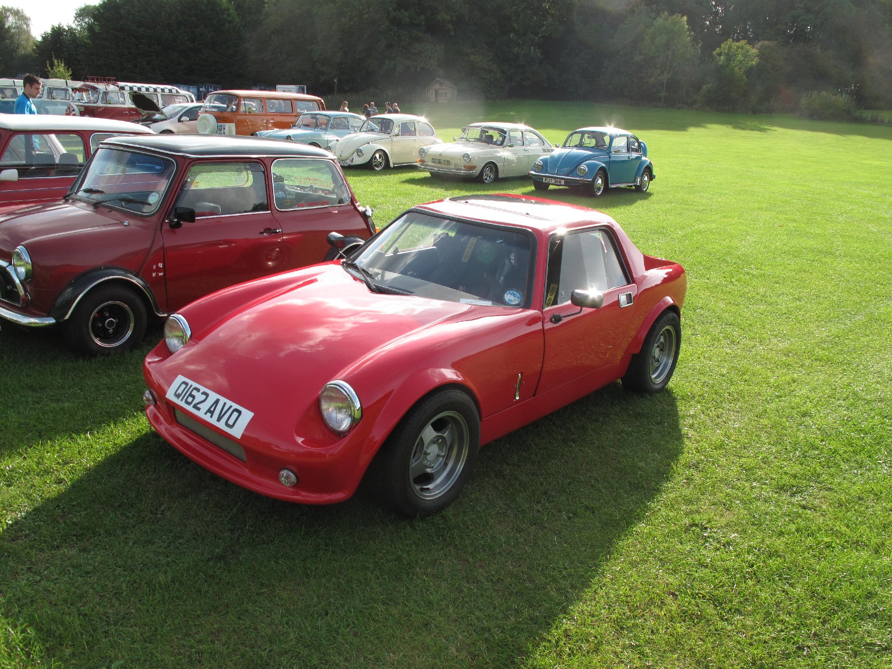

It had its first “outing” today to the Crotch Coolers meet at Alton in Hampshire.
http://www.crotchcooler.co.uk/
This is an informal meeting of classic car enthusiasts in Alton Hampshire
I have not done much to the car since I got it from Woody. It now has a removable steering wheel, which helps, and a reclining seat in the search for headroom
I have fitted hotter plugs to the engine that Andy built an it runs more cleanly now.
At speed it tales my total attention !!

Hi Martin, the Coupe is looking good, I'm interested to see that you don't have the ridge on the leading edge of the bonnet where a Mini bumper is supposed to fit, was that filled in, or were bonnets made like that? I've been looking and thinking I will have to fill mine in, the chances of finding a mini bumper are about zero here :lol:

Only the Cox and euro front did not come with the ridge to my knowledge

The bumper recess was filled in by Andy Spalding.
This can be see on Andy's Project thread.
andys-83-coupe-t577.html

:roll: :roll: Where am I going to find expanded foam, (similar to that used making race car seats) in Kano?? I was thinking along the lines of carving styrene foam to the correct section, gluing it it and then covering with a layer of glass mat.

Expanded polystyrene (and DIY single component expanding polyurethane foam) cannot be used as it dissolves in polyester resin.
I used rigid polyurethane foam to fill in most of the slot then glassed over it leaving the surface just below the level of the rest of the bonnet so that I could fill and sand it.
You could also use the two pack expanding polyurethane foam.
In the UK you can get them from East Coast Fibreglass.
http://www.ecfibreglasssupplies.co.uk/c ... board.aspx
http://www.ecfibreglasssupplies.co.uk/c ... iquid.aspx

I used builders spray expanding foam. The stuff they use to fill big gaps.
Also florist foam, the green stuff they stick flowers into ( Oasis ?) can be used.
If not cover the foam in brown tape or tin foil to stop it melting long enough to glass over it.

From the marks on the engine cover, it looks like someone had a wing in it once. I would be surprised if that improved the looks.
