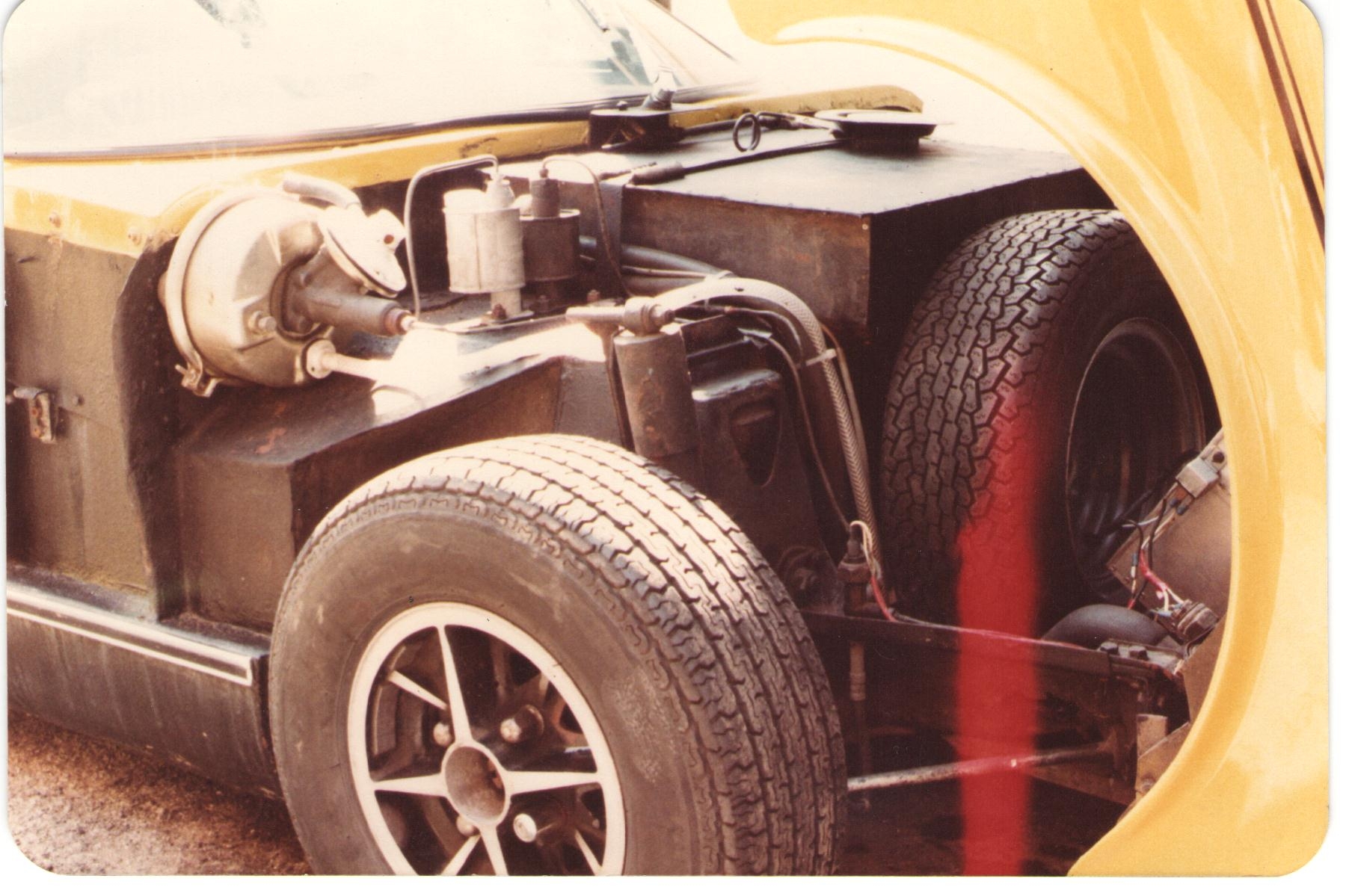

This was my old Cox tank installation made in 1980

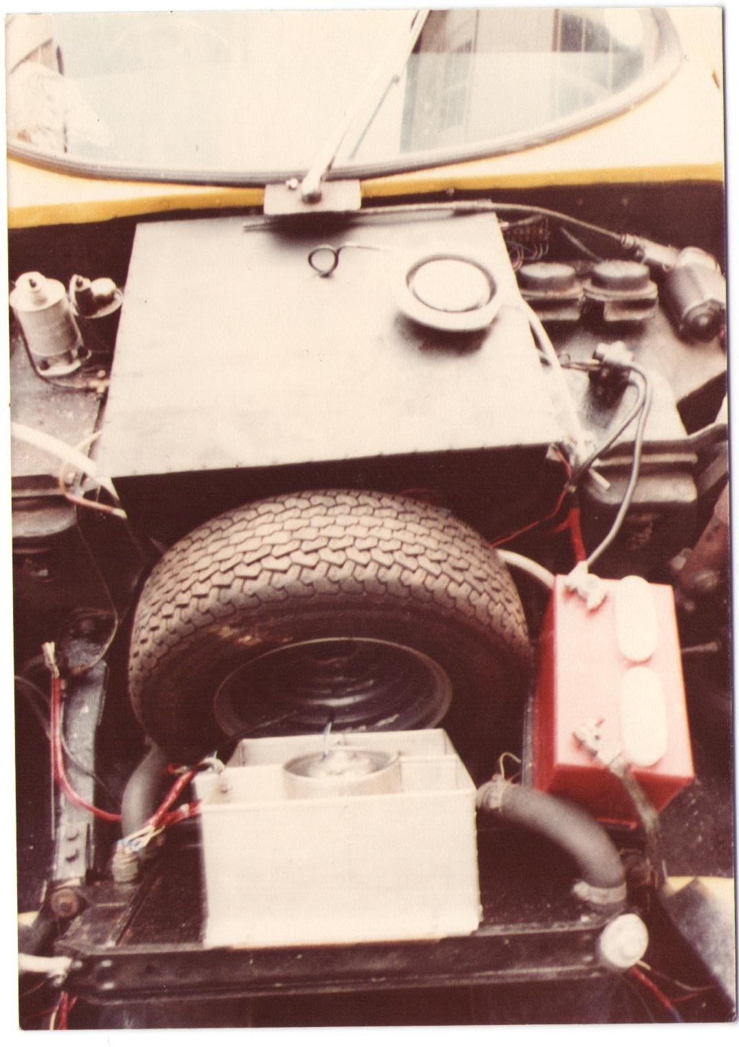

another shot
