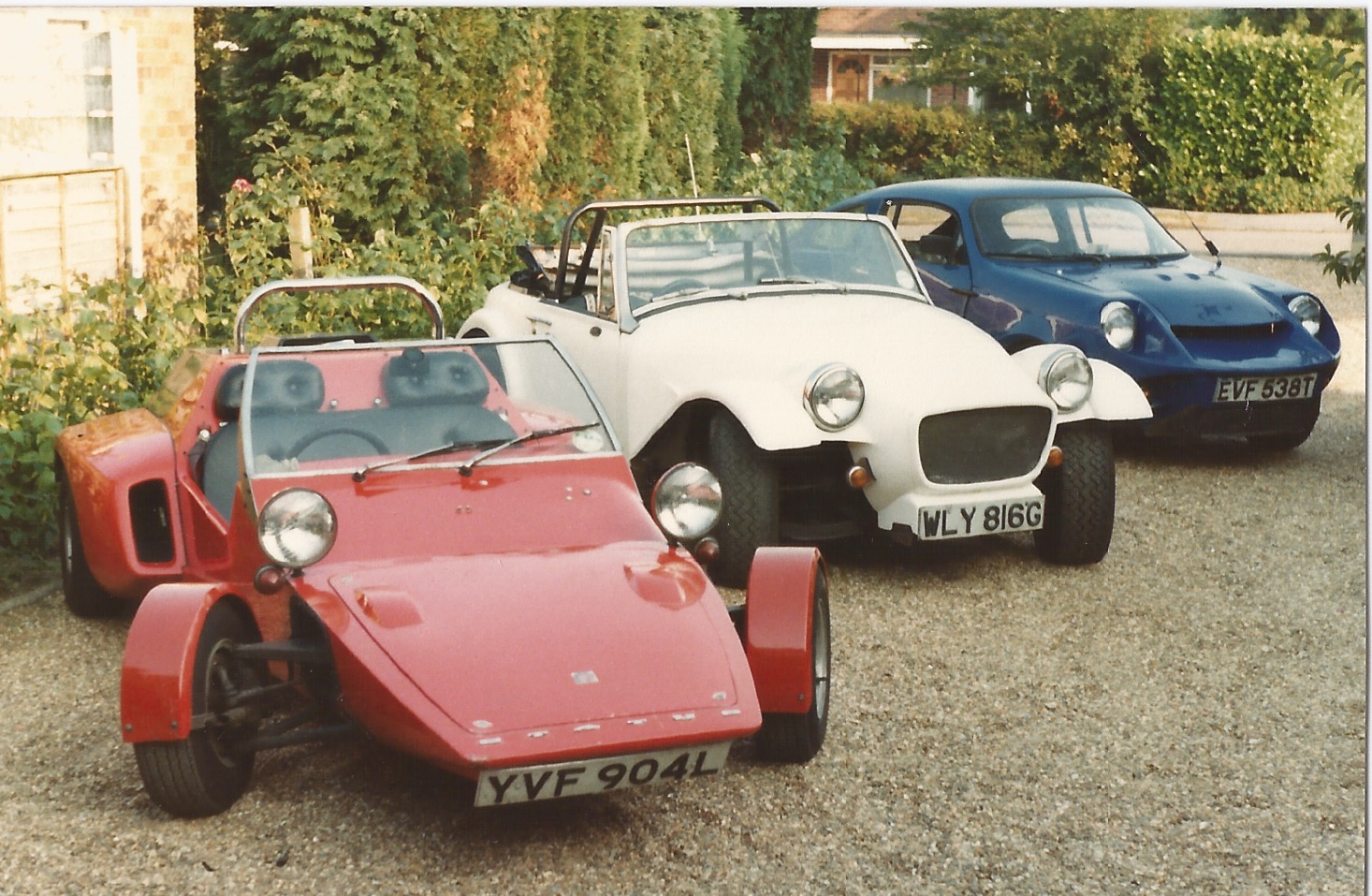

My brothers Arkley ss from circa 1982-83 (the white one in middle)
Looks quite pretty when put beside a Mini Marcos & a Status Minipower !!! :lol:

As I said "beauty is in the eye of the beholder" -- of those 3 the Status would be my choice -- very Lotus 72!
I've owned a lot of cars over the years & that Status is one of the only ones that i regretted selling! :cry:
I was only 17 when i bought it. Too young to appreciate it really!
