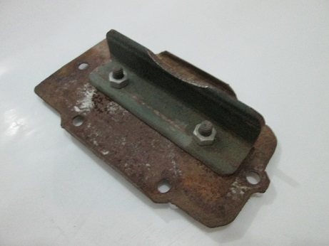

Hi PMC,
The standard bottom plate on the BL Mini rod change box should have a vertical plate running along its center line, the the gear lever should touch in the 3-4th gear slot giving something to "lean" against when looking for those gears, the gear lever is lifted to clear this plate when entering revers gear, I don't have a picture of the original plate but have attached one I made that was slotted to allow adjustment when my gear selector housing was reverersed for twinny mini use

Hmm interesting, I've not seen one of those before :wink:
