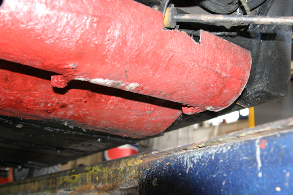

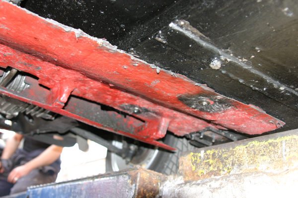

I posted pictures of the exact idea on a post here somewhere.

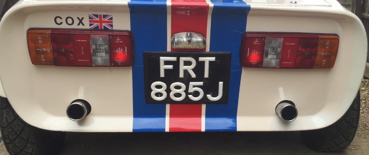

Here's a picture of the rear of my Cox
A rather helpful little mod that's is do'able as you have a black and white number plate car.
Think black aluminium outer number plate surround, with the center cut out, and a fine mesh painted black fitted in the center.
Then re-attach the white numbers, like a early lotus style front number plate.
Now all the hot air that usually gets trapped at the rear of the engine bay can escape. :idea:
Also if you have air movement from your fan, plus any engine bay ducting, it should create enough air flow/movement.
Plus the other cooling mod we discussed. :wink:
You could also lift the rear edge of the engine cover like the CCC Cox boys do.

Sorry I didn't mean a flat floor was a problem I mean the GRP deflector you posted might be considered a bit OTT.
My Heerey has no holes underneath ans I will be smoothing out the front except for the rad exit (which I may still send through the wheel wells anyway). At the back I was thinking a fan sucking air from underneath to get the air moving in the engine compartment.

That is a good idea to get the cooling of the luggage compartment, like the front of an Elan? I was thinking of slots along the bottom edge of the horizontal piece that runs along that back of mine, mine is not flat like the Cox, but the principal is the same. If I did that on mine I would do it with a rectangular plate as a square one wouldn't work on the Heerey rear. Where do you get the numbers?

I cut a large circle out behind the plate and used spacers to mount it. The panel has a curve so it vents at each side.
Saying that I've never had a problem, in fact on the road it is only on a rare warm day that the central tunnel heats up.

Hmmm, that may well be a neater/easier solution Ken, I could put a series of 50mm holes behind where the NP goes and add some spacers to the plate. Nice.
