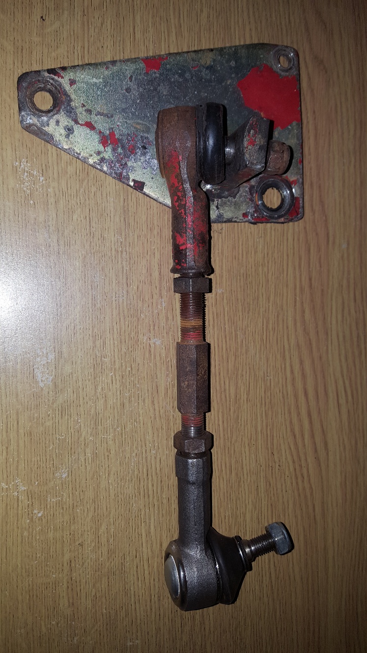

I have found an issue with one of the steering arms that lock the rear wheels. the thread has gone,
I have included a picture of the good one below from the offside, i am hoping this picture size is within the forum guidelines otherwise i will try and get the picture size smaller,
I was wondering if anyone know if there was anywhere i could purchase these threaded bars from or if anyone i offering an alternative solution to locking the steering on the rear wheels?

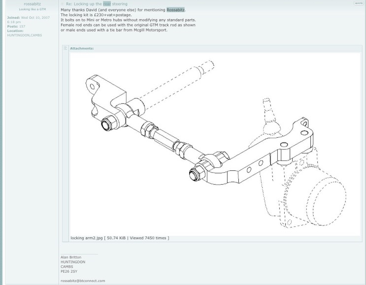

I’ve just done a quick search.... rear steer Rossabitz, and came up with this. 8)

The Rossabits steering lock does have the advantage of using the upper suspension arm pivot as the mounting point for the inner spherical joint, removing bump steer as the suspension goes up and down, there is a company in Scotland who sell threaded adjusters, but I'm wracking my brain to remember a name, or if you have a local friendly workshop that could produce for you, If you look Kano Coupe thread you will see my efforts at rear wheel locking, very similar to Rosabits.
Wed Sep 26, 2018 12:08 pm
Post Re: Help required with rear steering locking arms?
Get some hex bar and turn it down and cut a thread on (or get a friendly person with a lathe to do so for you). I'm guessing one way will be right hand and the other way left hand thread so you can adjust it with a spanner on the hex section.
That will be McGill motorsport
http://www.mcgillmotorsport.com/rod-ends-bearings/
I can vouch for the Rossabitz setup as I'm running that on the rear of my coupe.

I can supply all the parts for the GTM set up as well as a kit
for using spherical rod ends from McGill.

Perfect fit Alan!!
