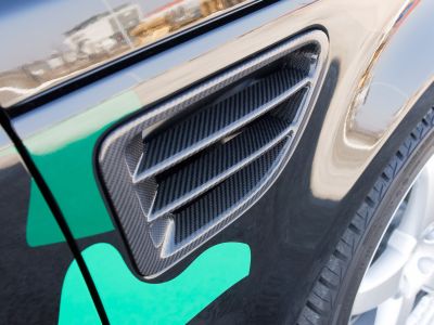

I was thinking more on the lines of Range Rover
2006-Hamann-Range-Rover-Sport-Camo-Carbon-Fiber-Side-Vents-1920x1440.jpg [ 42.24 KiB | Viewed 8985 times ]
I was going to have a look at the local scoopermarket as well :roll: :lol:
