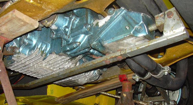

I am so close to getting my car on the road. Everything checked out, engine set up. When I tried to select the gears the only ones I can get are 3rd and 4th. Please look at the photograph. I have removed the linkage and tried to put into gear using the stub, with the engine running and stationary. SOOO frustrating.
Does anyone have some suggestions?

You have the early mini remote gear change gearbox (pre 1976 ish...)
Having had this type and the later rod change gearbox, I would opt for the rod change.
It would involve fitting a complete new gearbox and change mechanism.
I think rossabits still sells the gear mechanism so conversion should be reasonably straight forward.

Check that you do not have a Coolant pipe/Jublee clip hitting the selector when you move it across to the 1st/2nd gate, Back in my early coupe ownership My coupe had the same selector rod as yours, and after doing some mainatance I found I could not get 1st/2nd it turned out to be the jublee clip I had just replaced and repostioned nicely to make it easy to tighten, get some one in the car to move across the gate and select what gears they can without forceing anything, and check your clearances. my money is on something around the tunnel causing a clearnace issue. It has to be checked with someone operating the lever inside so any flex in the linkage is there too.

Is the magic wand set up the same as the remote rod? If so, the plate on the bottom of the gear selector needs swapping around, otherwise 1st and 2nd are gated and reverse isn't.
It is probably what West said though. :wink:

Am I right in thinking you're going to use a later rod chnage with the gearbox in the picture? If so the change will work backwards -- 1st is 4th etc -- 'bin there done that!

The gears with the rod change gearbox will be in the 'correct' places if you use the corresponding rod change remote and the GTM designed linkage which differs significantly from the original remote change shown in the pictures above.
The only thing to remember is to take off the bottom plate of the rod change remote and rotate 180 degrees and fit the gearstick locating dowel pin into the opposite side of the housing.

And to move the reversing light switch, to the other side too. :wink:

After removing the gearbox again I stripped it completely The 'detent' pins locating the shafts had to be hammered out as they were seized solid.I can only assume that the box suffered corrosion as it stood unused for so long. The pins are now cleaned and the holes have been reamed out. The box is now rebuilt and ready to be fitted back in the car.
Finally the car will be ready for the road. (Never give up )
