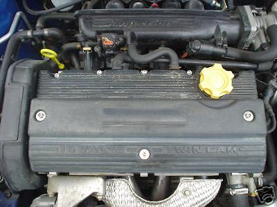

Can you confirm the EU3 engines:- "are identifiable by a lack of distributor and a larger plastic spark plug cover (hiding a pair of coilpacks)."

Post Re: Which k-series?
Yeah thats right. They have a plastic part to one half of the cam cover which hides the coil packs.
