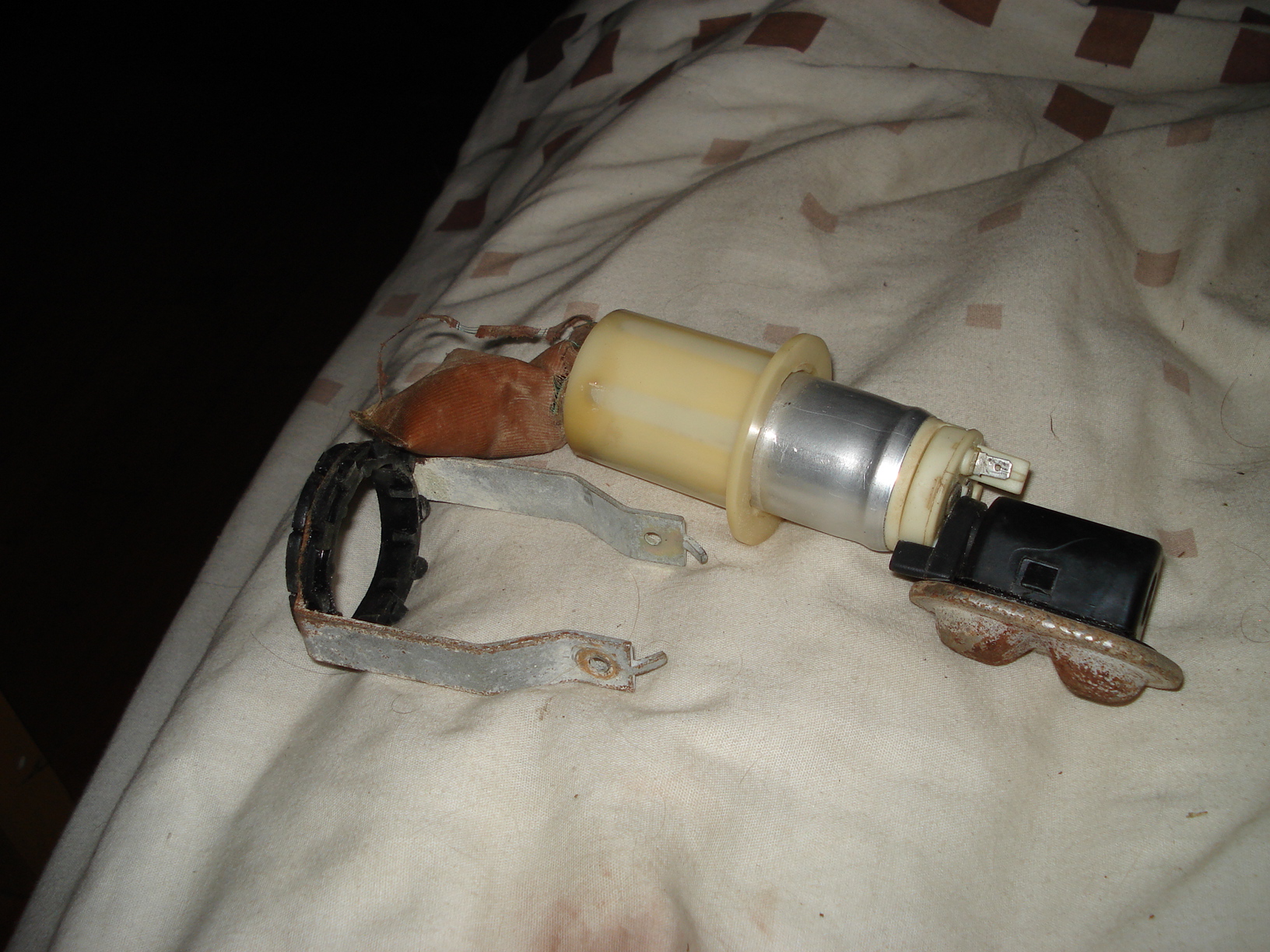

Hi Guys, Any help appreciated here. Read quite a few replies regarding fuel pump/inertia switch probs and can confirm my intank fuel pump is shot. Managed to remove it and wire direct to 12v...... Nadda. What part no do I need and what Main dealer supplies same. I'm not sure what size engine I've got either. Where is Engine# ???

Hope the picture helps

http://www.auto-sensors.co.uk/rover-met ... -802-p.asp
Sierra 2.0i pump is the same
http://www.ebay.co.uk/itm/Fuel-Pump-CIT ... SwzgBY4lXw
