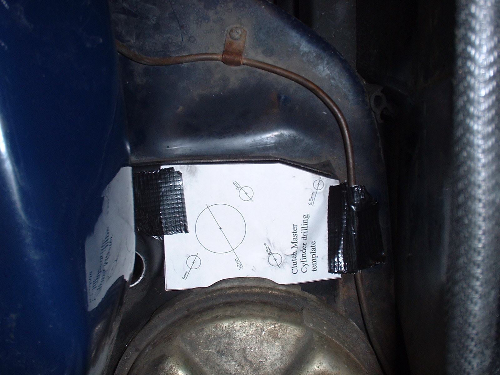

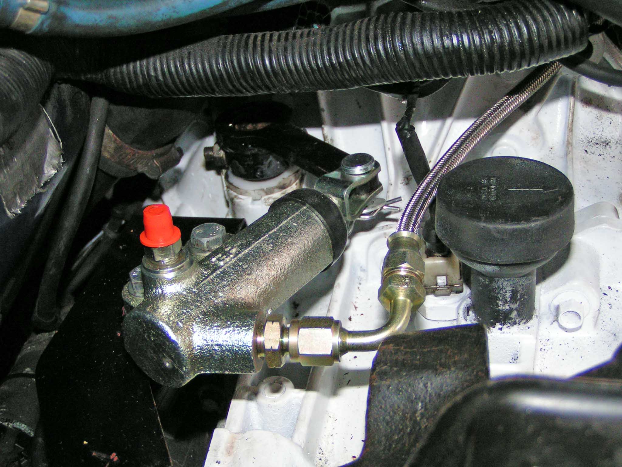

Hello, I bought a kit from Dudley at Talon Sportscars. I will try and attach some pics. The gearbox I decided to paint white before I fitted it!!
On the paper template the mounting holes for the master cylinder are not in the wrong place. I would offer up the mater cylinder before drilling the mounting holes. The master cylinder on the top has to be aligned for good pipe routing.
