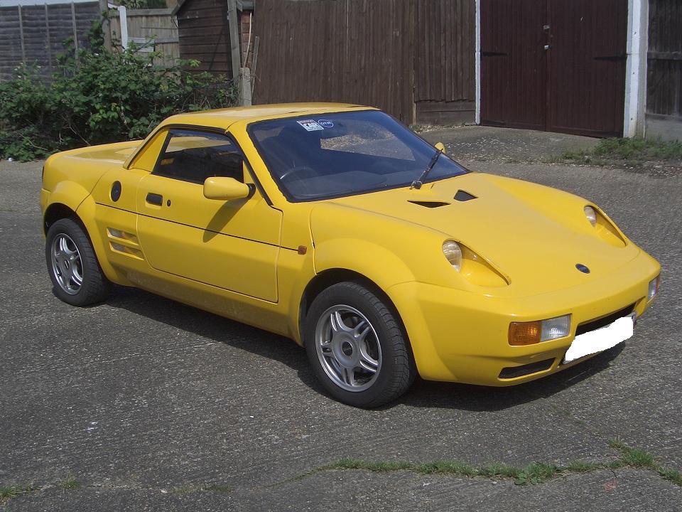

I want to upgrade my 13" metro wheels to 14" wheels. I think the 13" look too small and I am concerned that 15" will look too big. However I am having a real job finding anything suitable. I like the idea of minilites but can't find any with the right offset. Has anybody any experience / ideas as to wheels that fit, please?

Also what are Talon fitting on the RT100 ?

Thanks Malcolm. These look great. What style are they? I can't find them on the Team Dynamics web sites.

Ah well - there's the rub,,,, I've had the car since '97 and they were on it when I got it.
