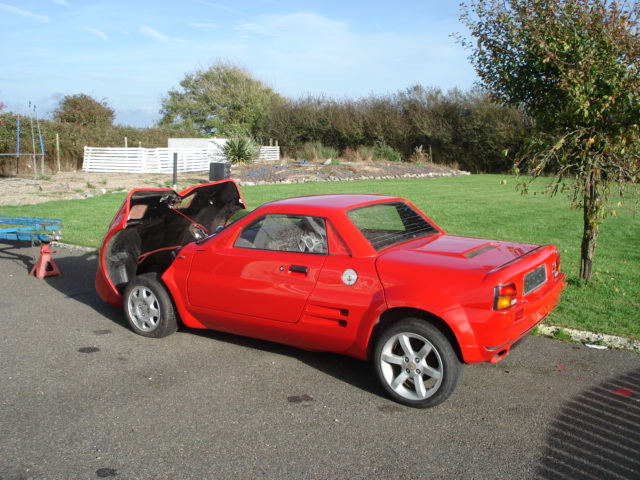

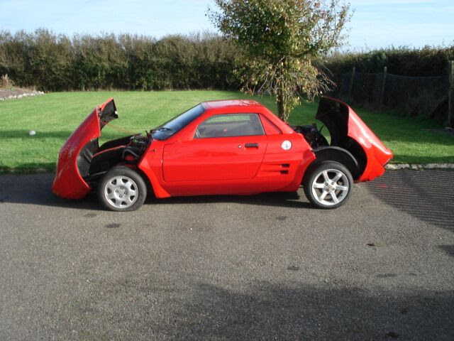

Hi Jay, I have a staggered set on mine :?:

Is there much poke beyond the wheel arch line, as I don’t fancy fitting arch extensions?

No, all 4 sit fairly flush. I haven't actually driven her yet, no exhaust. Is there truth in staggered being necessary ??
