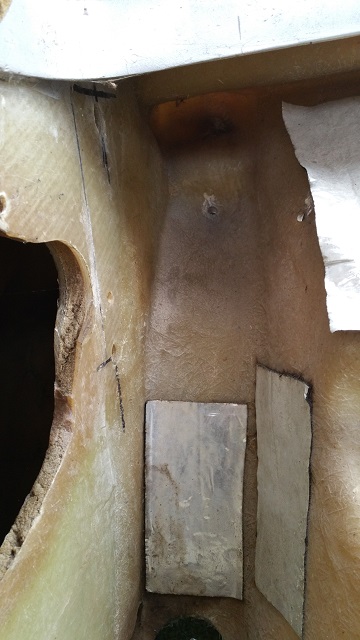

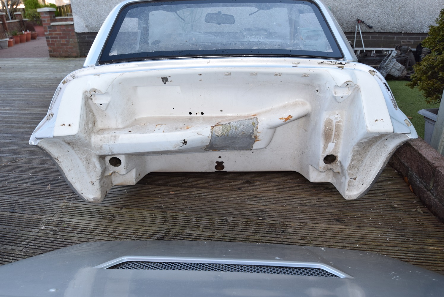

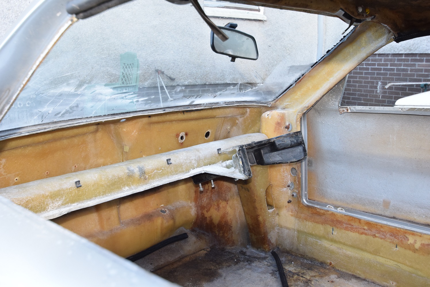

Hope these photos are what you are looking for.
The previous owner cut some of the dash support away, the main strength beam can be seen intact.
I am in Erskine just outside of Glasgow.
If you need some other shots just let me know.

Those photos are SUPERB and just what I needed. I should be able to increase the structural rigidity before adding subframes and better rear links.
The only other pics I need are one of the underside of the tub and one more directly into the rear, to show the inside of the rear where the subframe tubes triangulate to the body.
Wolverhampton is a 10hr round trip with no breaks so thank you for the information.

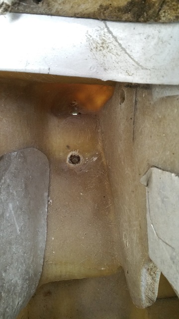

Here are the photos you asked for. I am not well enough just now to turn the tub over, the underside is completely flat apart from the central tunnel that the water pipes run in.
