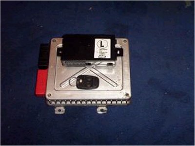

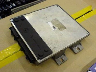

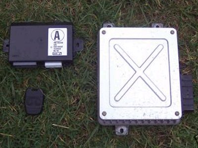

hi have just got a new k3 engine have i got this right .
photo one is a mems 2 no vvc with one plug
and the second photo is mems 2 with vvc with red plug
and photo 3 is mems 3 with 2 black plugs

I think what you have stated is correct.
