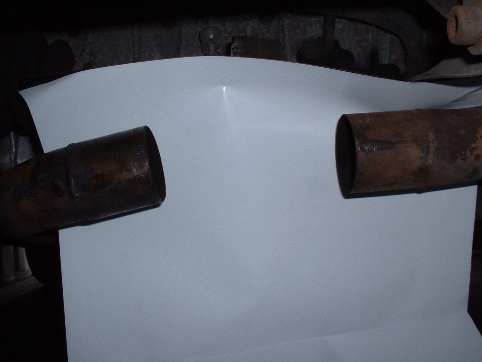

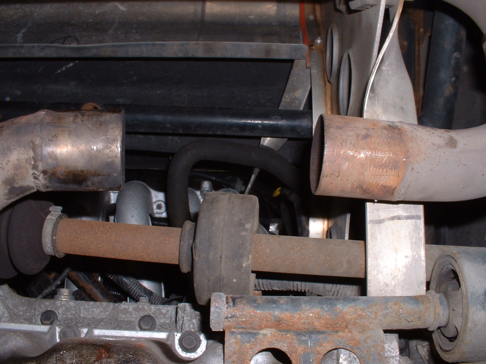

There is or was a problem with the exhaust flexible, on our Libra the two pipes it was fitted between where not in line. We had three flexibles before we realised what the problem was. We did some drawings & measurements & went back to the origional suppliers (in Huthwaite near Mansfield). They reshaped our pipework & supplied a new flexible & we have gone about 5 years without having to replace it - if you send me an email I will send you the series of photos. grandadbarry70@virginmedia.co.uk

You were correct Barry with"Looks like you have a blown fuse (or dirty contact) on the offside main beam fuse F5 (10amp)" The misalignment is pretty bad in the photo's. I will have a closer look at my car tomorrow with this in mind.
