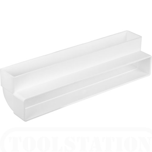

I found some flat ducting in Tool Station 225x25mm. I am toying with fixing a 90 deg bend to the rear of the floor pan and use the ram air effect to get some fresh air in the engine bay.

That looks like it's worth a go. The biggest issue is likely to be ground clearance which is only 5" and a bit. Winter fun :D

I was more worried about it over heating ! I was going to cover with ali duct tape.
I think the ground clearance should not be and issue as the duct will be close to the wheels.
I have also been toying with getting a sheet of steel bent up in to a top hat section about 40mm deep and as wide as posible to screw to the floor pan with some kind of scoop at the back to push the air into the bay.
The biggest problem is the lack of space. Both of ductwork and the passage of air.
I will post some photos if I do find a worthwhile solution. I may prototype one with that plastic sheet that they use for house for sale boards.
