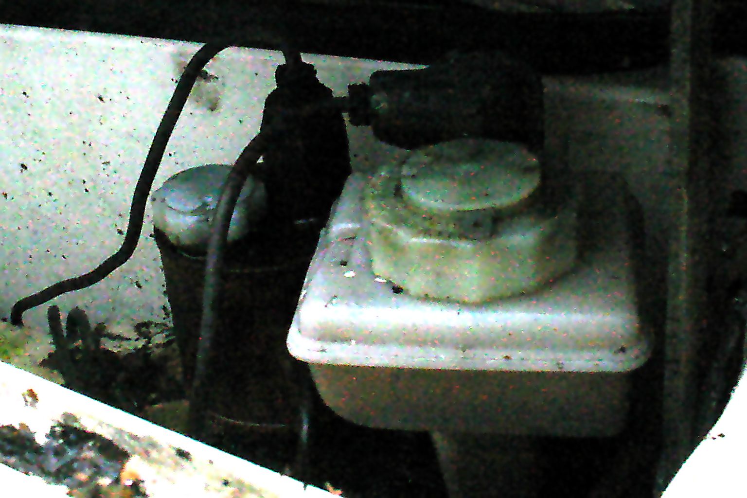

of a metro brake master cylinder in place beside the clutch one? I'm particularly interested in seeing the orientation of the tank and how it all fits in but ANYTHING will be worth seeing - you never know what you might pick up that somebody else takes for granted :) Thanks.

Hi,
Hope this helps.
I have some more pics if needed

That's great, thanks :D (I just zoomed out on my screen and can see it fine) Any more, anybody?

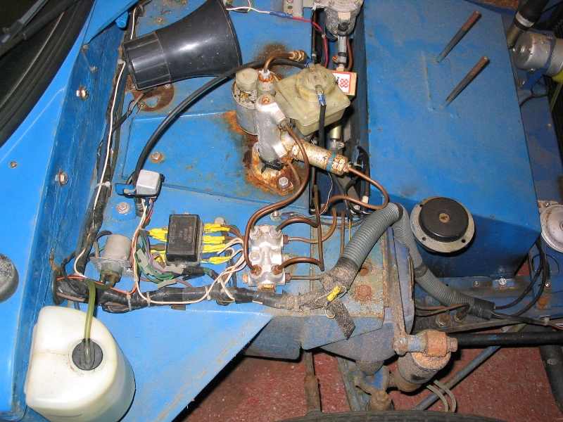

This is a Metro (A+ series 1985) master cylinder minus its servo unit. I just added new studs to the pedal box for the slightly wider pitch on the mounting holes. This is on a coupe though..

That's how I thought it would go but on the Rossa the reservoir can't go there because of the 'bulkhead' created by the front tub - you can just see the top of the clutch cylinder over the top of it in the photo below. Maybe I need to cut a bit out of that... Anybody got a foty of one on a Rossa?
