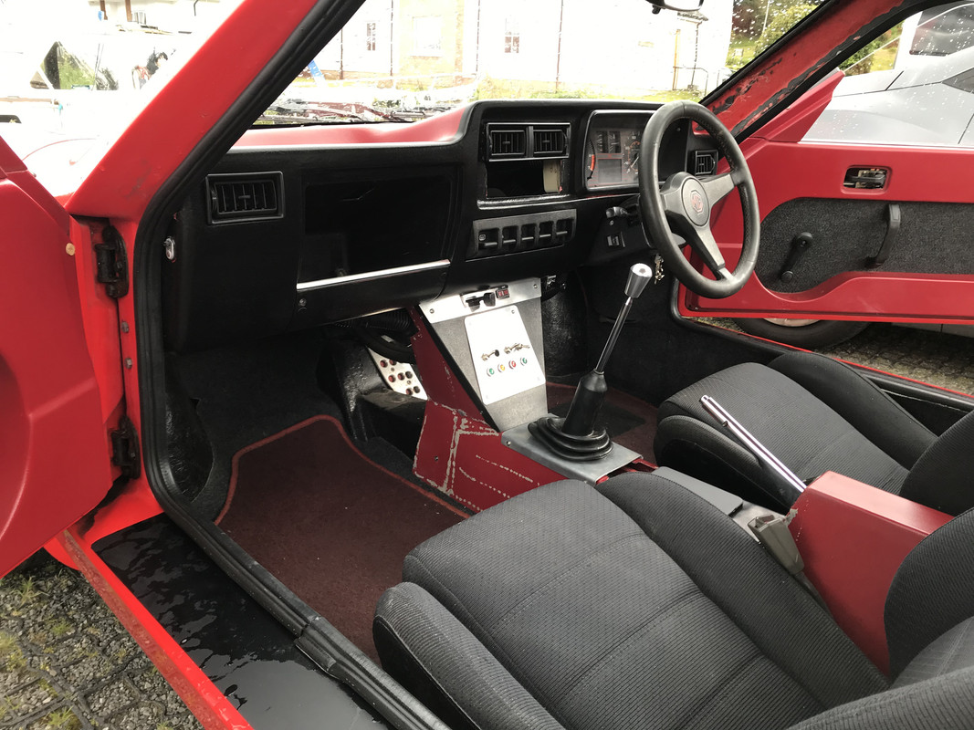

The K3 is smaller inside than the Rossa and where I felt it was in the footwell with my size eights and constant clashing with the underside bits of the heater, but headroom was ok, as I had a pair of Rover Coupe seats fitted really low and reclined ever so slightly to stop the hair getting messed up, whilst they go further back as there is no fuel tank behind.
The Rossa also has a centre tunnel, which really should intrude but doesn’t at all and provides a handy little resting place for the left elbow :)

I like the dash in the Rossa. The whole interior looks more roomy. When I get my K3 finished I'll do a few meets and hopefully check out a few of the other cars.
