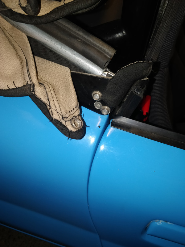

Had another look at the soft top which once I had a proper look fitted quite easily, but it looks like I should have a press stud somewhere or do I have a piece missing?
It's the same both sids

Hi thats funy i have 2 bottom press studs and one top part

Thanks for that, you appear to have some weather strip on the metal bars as well.

Posts: 399
Post Re: Let the Journey Begin
Its a piece of aluminium with some
door seal on it.
So when the window is up it seal's agents
The window
