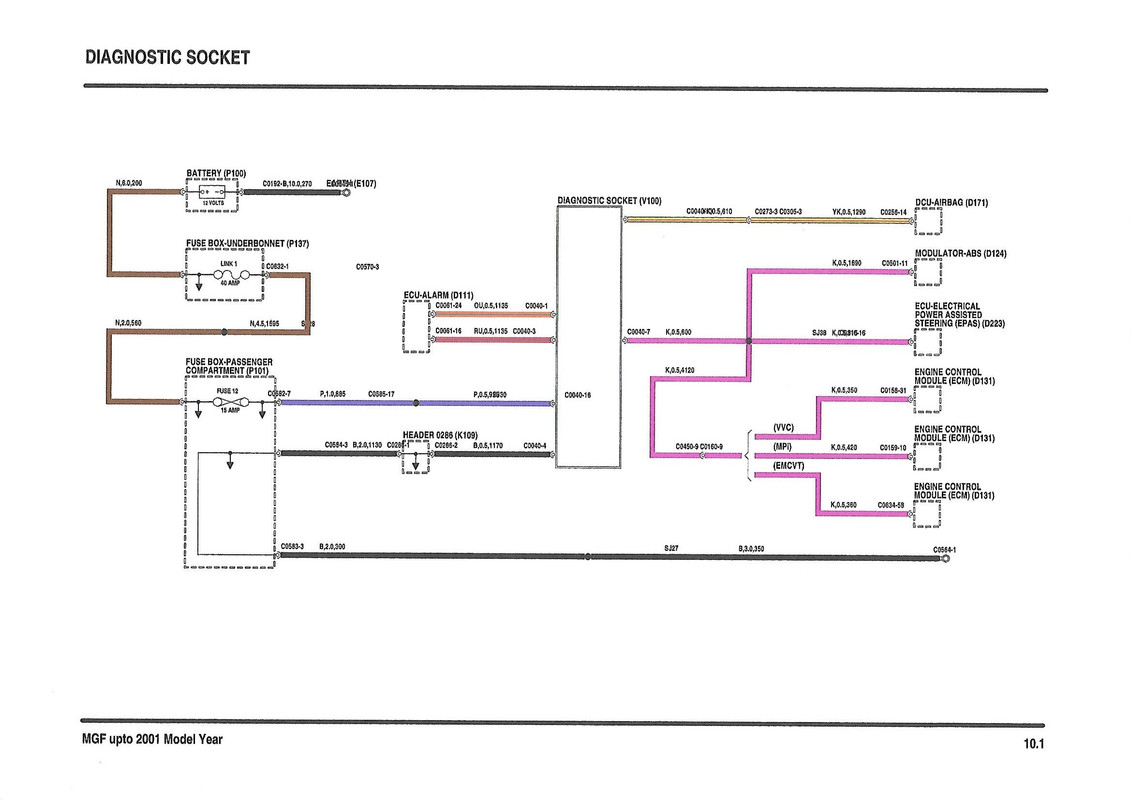

Hi all,
Does anyone know how the diagnostic socket for the mems3 / 5AS equipped engine is wired?
Mine has a red power wire, pink wire to the ecu and that’s it. It did have purple, orange and red/green wires that went to the 5AS unit but I ditched these when I found the 5AS unit was faulty so I did away with it and fitted a different immobiliser.
Does this socket need an earth?
I’m hoping to plug in an OSB2 code reader to see if it will tell me why my engine is in safe mode and limited to 5500rpm? it’s idling at 1200rpm also so it’s something to do with the VVC mechanism. At present the code reader won’t fire up?

hi i have this
DESCRIPTION AND OPERATION
DIAGNOSTIC SOCKET
DESCRIPTION
General
The diagnostic socket is located immediately above the passenger compartment fuse box.
The socket is constructed to SAE directive J1962 standard and allows attachment of
TestBook, or any other SAE standard diagnostic tool, to the vehicle for fault diagnosis
checks.
OPERATION
Power supplies
Fusible link 1 (C0570) of the under bonnet fuse box supplies a permanent feed to fuse 12
(C0582) of the passenger compartment fuse box on a N wire. Fuse 12 supplies the power
feed from the passenger compartment fusebox (C0585) to the diagnostic socket (C0040) on
a P wire. The diagnostic socket (C0040) is earthed on a B wire connected to an earth point
(C0564) via the passenger compartment fuse box (C0584 and C0583).
General
The diagnostic socket (C0040) is connected with the following on K wires, which make up
the ISO 9141 K line bus:
 The ABS modulator (C0501).
 The EPAS ECU (C0316).
 The ECM (C0159).
The diagnostic socket (C0040) also communicates with:
 The airbag DCU (C0256) on a YK wire.
 The alarm ECU (C0061) on OU and RU wires.

That’s brilliant, thank you.
I obviously need to earth the socket. Hopefully it will work fine with just the power, earth and ECU feed.

I wired one in just the three wires live, earth and communication.

Looks like I need to wire an earth to pin 4 on the diagnostic plug so I'm going to do that first and see what it throws up. After that a treble check of the wiring (the plugs are definitely in the correct sequence), followed by checking the solenoid resistances and trying a second cam position sensor I have.
