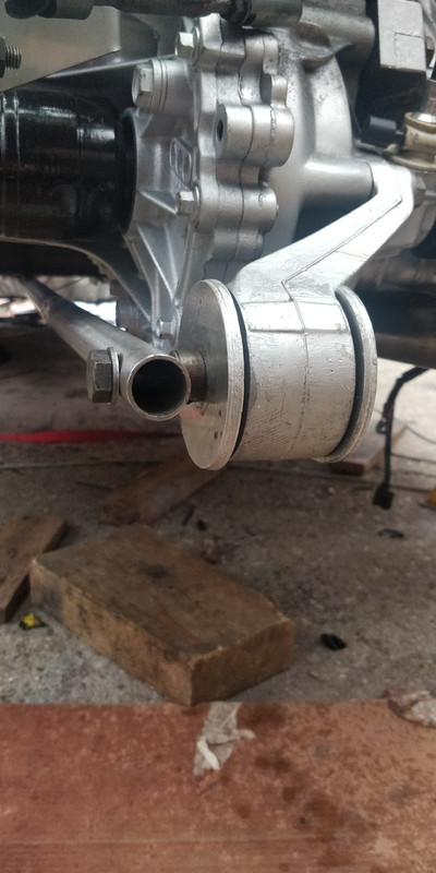

I'm having some problems with my libra's gear rods the ends are all messed up but I have an R65 Gear Boxx has anyone changed to cables and kept the R65 Gear Box
Image Image Image
Tue Oct 25, 2022 8:01 pm
Joined: Sun Aug 31, 2008 3:32 pm
Posts: 37
Post Re: Paul's libra
Hi, I am still using rod gear change on an R65 box & a Rover VVC 160. I Have replaced some of the links on the gear box with some small rose end joints & threaded bar. They don't pop off when the plastic cup wears. The GTM vertical pivot assemble at the back is ok even though there is some wear in the plain bushes at the top & bottom. You do need to keep the pivots lubed fairly often or the gear change becomes stiff in the fore & aft movement of the gear lever.

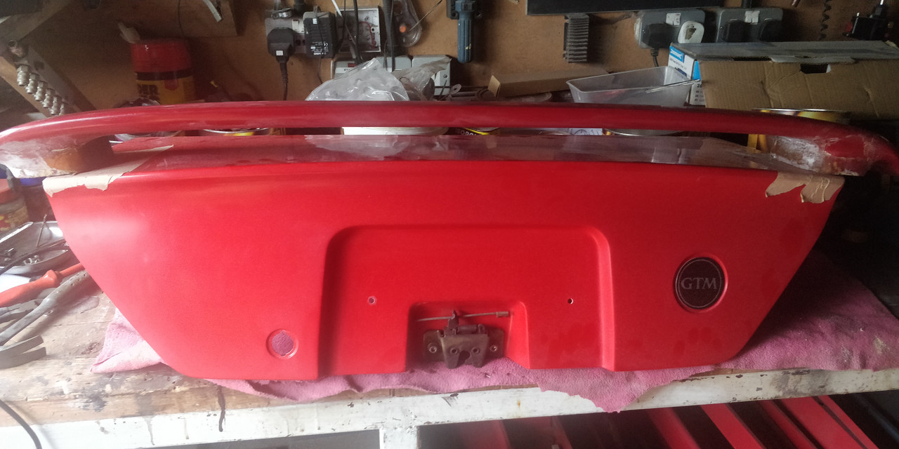

I have got a boot spoiler for the car it's from a Honda Prelude.
This will not fit the car it needs a bit of work on the fixing points thanks to bob for the information on what needs to be done.
the spoiler needs to fix the boot and not the back of the car
. Image Image Image Image

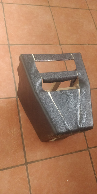

I have made a center console for the radio
Image ]
