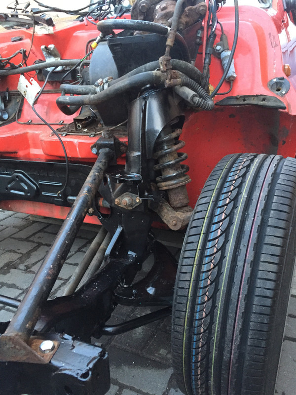

I have used the MGF rear anti roll bar which fits on brackets hung from the rear subframe mounts. There is a tiny bit of clearance needed where it bends but it should work fine. Though I have used the MGF rear suspension setup. You will see what I mean.
Peter
Did you have any clearance issues at the body tub mountings for the MGF tie bar set up?

Post Re: coilover brackets
I take it these would fit a Metro/R100 front subframe?
If so I would be interested in an assembled pair if they are still available?

Hi John,
Using the MGF subframe you will need to cut off the outside brackets as shown in the photo. The subframe will then fit into the tub mounts using the long bolt shown. The tie bar is not affected.
Peter
Perfect, as I was was concerned that the front trailing arm mount would foul and judging by some of your other photos, the TF subframe could be a possibility too.

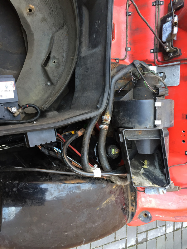

hi peter
on the front passenger side do you no if the coilover bracket
hits the heater fan box
Image Image
thanks paul

Paul.
When I built up my K3 using PEEPS brackets, there was clearance for the heater box, as the height is only a few mm taller than the hydragas spheres but sadly I cannot find a photo showing it fitted.
For reference, the MGTF front strut towers are taller than PEEPS brackets and there was plenty of clearance as shown on my K3 thread.
