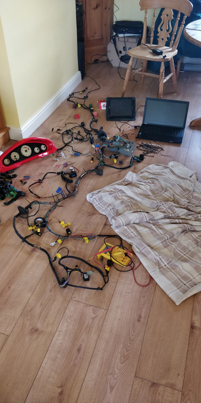

I have stopped working on the wiring for now I need to get the middle part of the loom from the car

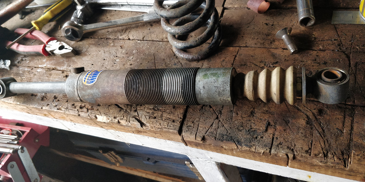

I have taken the front suspension of the car and stripped all the parts
I will send the Coilovers to gaz for servicing

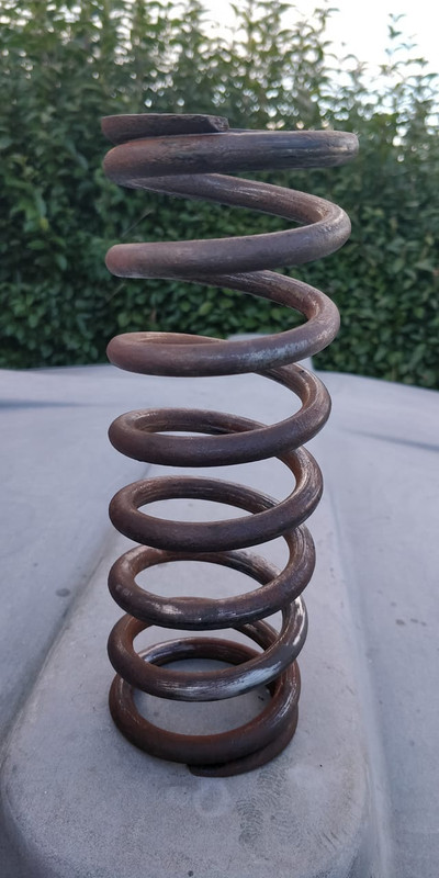

the springs I have given them a clean and sand. they have come up very good so I will give them a re-paint (with flexible paint).

I have started to strip down the back suspension I have taken the gaz suspension off and sent it back with the front ones for service
and fitted a bar to stop it from collapsing
I need to take the top ball joint off the hub I have read that this can be very tight so got one of these (46mm Slogging Ring Spanner Box End Striking Wrench )
I will give it a go and see how it works
the hub and the top ball joint are off the car and the slogging spanner worked very well

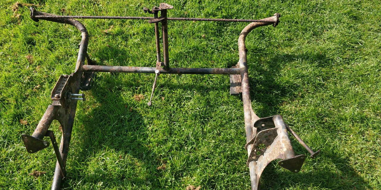

now I have the engine and frame removed from the car there is not much left just some pipes and the wiring loom the old frame it's not too bad.
I have a new one that was with the car
