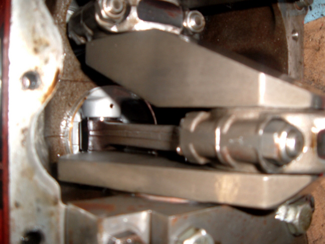

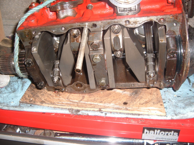

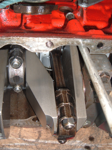

Are you sure about this crank as the Turbo crank (6232 crank) cant be stroked that much, due to rolled fillet radai (ie, an under cut journal) 83 stroke is on the limit. The only way that this would be possible is to weld up the under cut and then re machine down, Not nice. Is it possible that its a billet crank?

I think it's a billet crank:-
Am i right?

Yep that looks like a billet crank to me
Tue Dec 15, 2009 7:52 pm
Post Re: 1544 cc 5 speed box -what's it worth?
Certainly did not leave the factory like that :!: 8)
