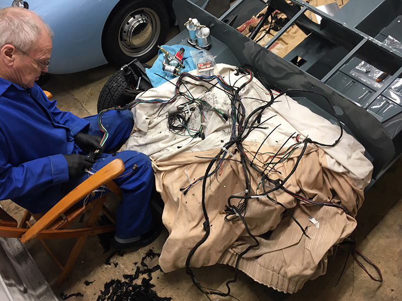

Been waiting for some Aeroquip brake hose bits to arrive so turned our attention to the loom. I think this may have originally been supplied with the kit back in '67 rather than extended by the original owner. Half is covered in material and the rest in tape. So we can check the condition and add in extra wires for the electric fan, rev counter etc we're completely stripping the outer and recovering it, very messy job...
Mon Nov 13, 2017 10:54 am

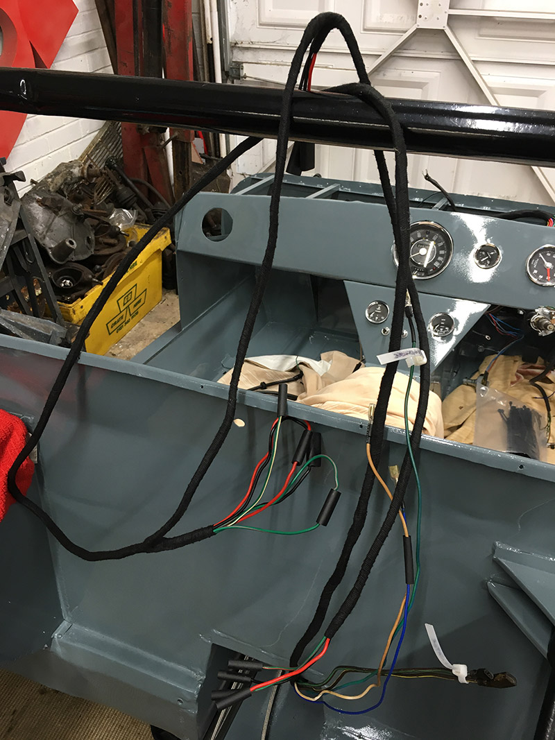

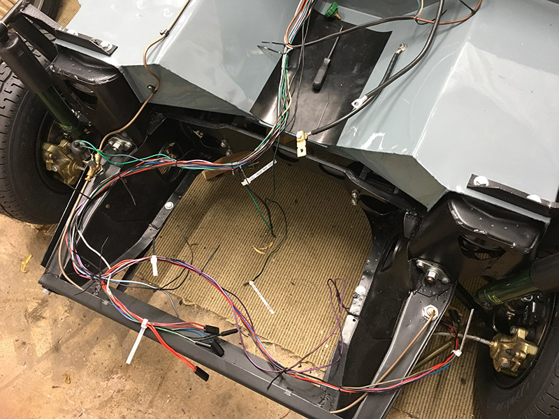

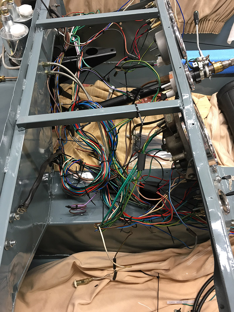

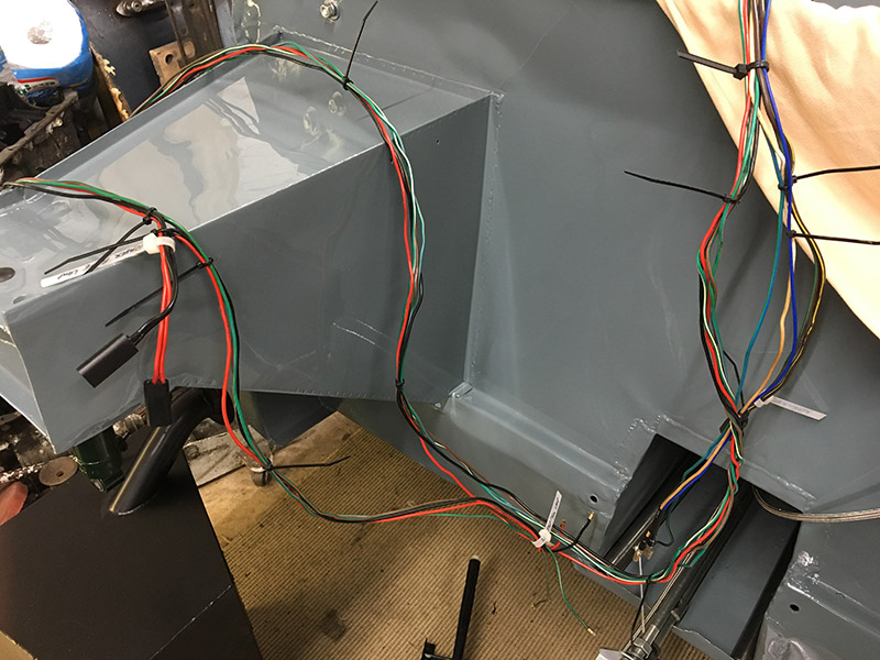

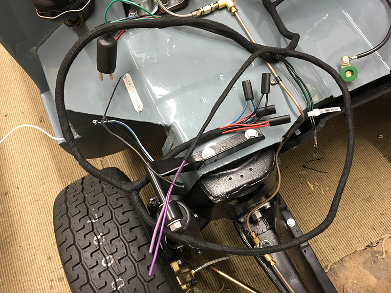

A bit of a photo updated all the electrics work and wrapped up, only a few wires to sort behind the dash and I'll take another snap. Next week we start on the cooling system...
Pre wrap...
Post wrap...
