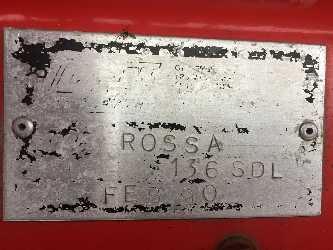

Oh and it has chassis no 136SDL/Feb 90, so assume an early Mk2.
