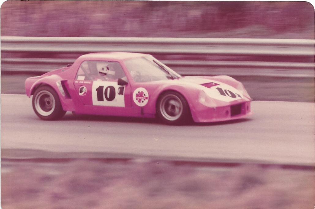

Ian Gorrie's GTM was low (and quick) with the gear change underneath the box??
