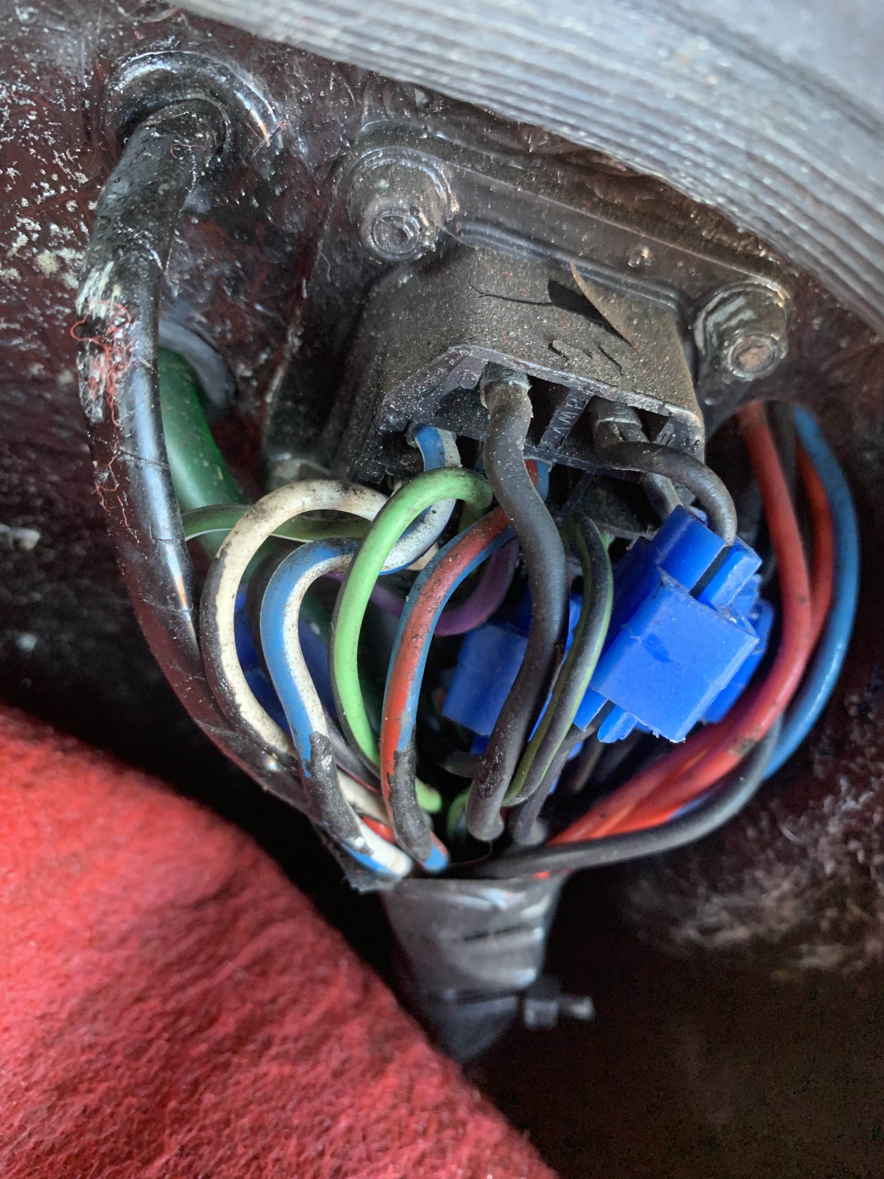

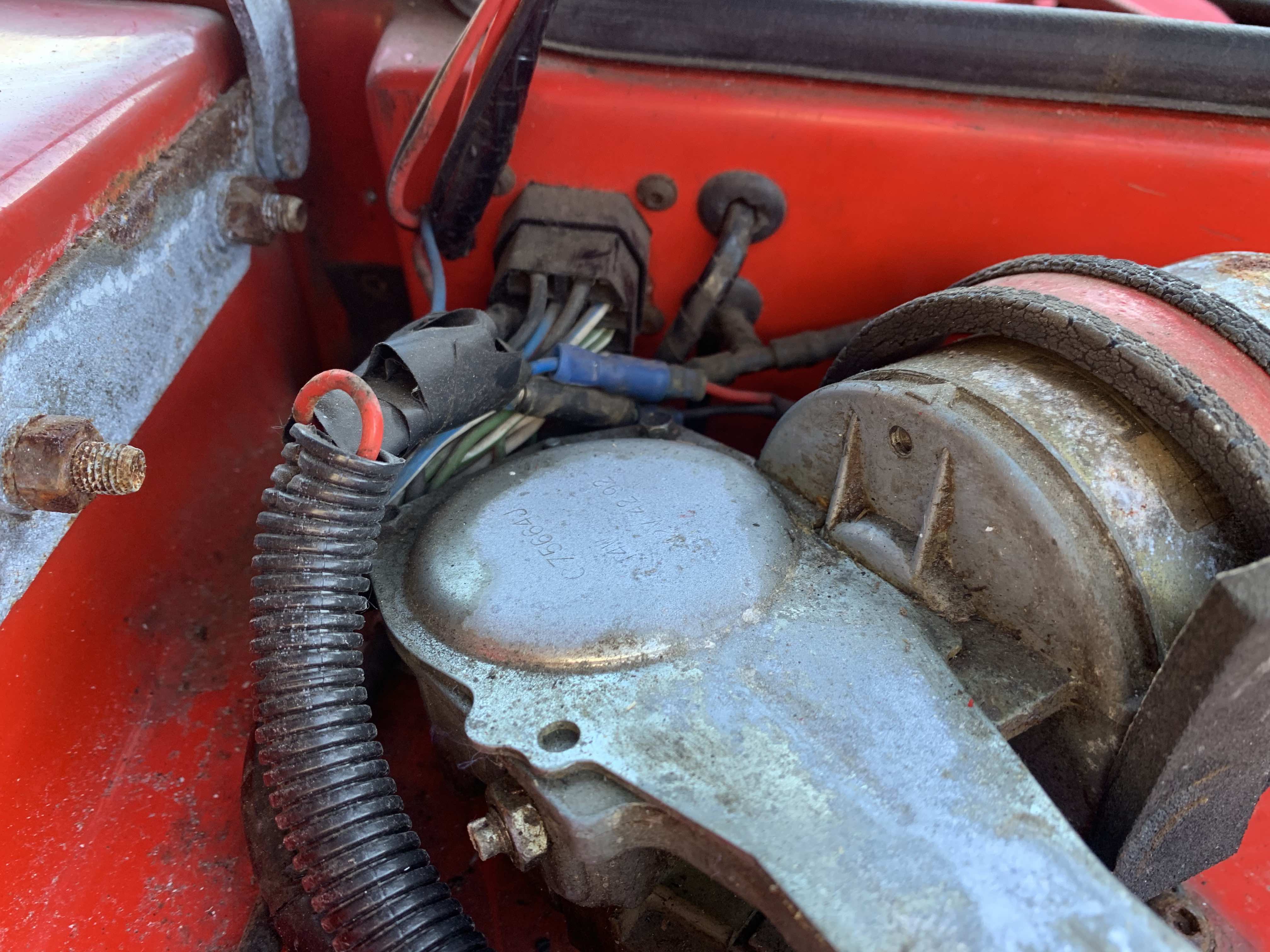

sidewinder wrote:
Pics?
This is the front one.The Male is a panelmount and fixedd to the removable section the femaleunplugs from it. I think its 10 way

Ha, Having just posted the pics which came up a lot bigger than I expected, I can see a manufacturer's name which I couldn't see with the naked eye
They are by AMP from Tyco TE.
Now I just need to work my way through their massive calalogue
