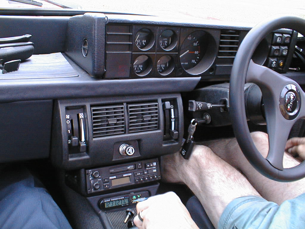

Hi Tim
I was not impressed with the column support supplied in kit.
I used 1" tube linking door pillars with the column suspended below.
A Metro heater fitted underneath with heater elements in demister
ducts and a Rover V8 pod containing fuses,switches and gauges
fitted above. Wiring was a nightmare. Different colour codes.
I should have fitted the heater further to the left.
File comment: Sorry about the knees !
