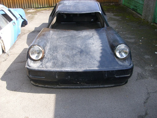

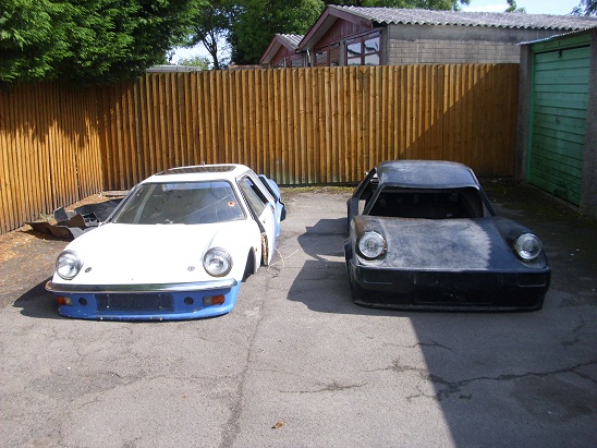

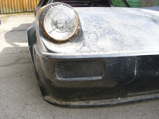

Hi,
I remember when I originally joined the site with a few pics, someone mentioned that my front was a bit different. To date, I havent seen another like it. Has anyone got any pics of one complete with the same front? Personally I prefer the more common front but I feel like I should embrace the rareity of this one.
Ta!

To me that looks like a Coupe/Rossa2 hybrid.
You might want to try Sierra driving lights in those holes.
There are a couple of other subtle differences as well:
The headlight "pods" are more pronounced. The middle looks wider - or it could be flatter. And the front bottom lip is a different profile to the Coupe. Makes it look like a Darrian.
I'm wondering if it was a factory styling/engineering exercise?
It would be a huge amount of work for a one-off otherwise.

Would this be one of the "export" fronts, I can remember some photos in the mid eighties of a coupe that the factory had fitted a revised front end.

Your front is a re-style by the factory.
As far as I know it wasn't popular at all, but a few were made for customers here.
I've only seen 3, A picture of the factory one, your one, and the Dean Thomas V-Tec Coupe (although it was modded to be wider).
I didn't know that it was for the "export" market :idea:
Every days a school day :D :D

Thanks chaps,
I've now got a dilemma, do I keep the unusual one or have a nicer looking car.....
I much prefer the standard front but it's also nice to have something a bit different, isnt it....?

News about this front end : It was developped in 1982 especially for me since I was working on type aproval in Belgium for the GTM , I have with Paddy and Pete discussed all this matter and there where several problems around getting Type aproval at that time , I never succeded because of braking problems with the prototype I had build and also about the position of seatbelt attachments and many more technically silly but for type aproval important matters.
Belgian and European type aprovals are not made easy for private persons .. so after two years strugling I gave up the whole attemp ; But I still posses the ONLY real OFFICIAL LHD GTM prototype that ever has been build and it is registered in Belgium in my name , unfortunately the car is now back in parts and pieces since It has been taken apart and been galvanized and powdercoated but no more assembled since then , however I will not part with it and plan to assemble it back again one day .
This raised and bigger bumperpart was especially designed because the lights are positioned to low for Euro ruling and also the original Minibumper was way to low therefore . There must however exist an existing mould for this frontend since it was especially made for us but stayed at the factory at Loughborough .

Just one more hint .. the bumper lightpods where made for Clubman lights
