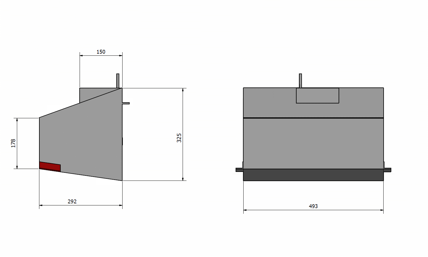

one advantage in working in a College is that there is always a engineering student looking for a project.
Just getting this made up in aluminium,
3d dwfx file

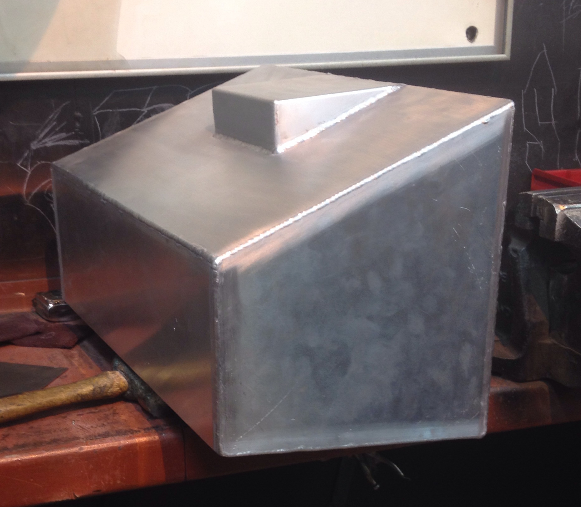

Post Re: Gas Tank capacity on GTM Coupe?
Preview pic
