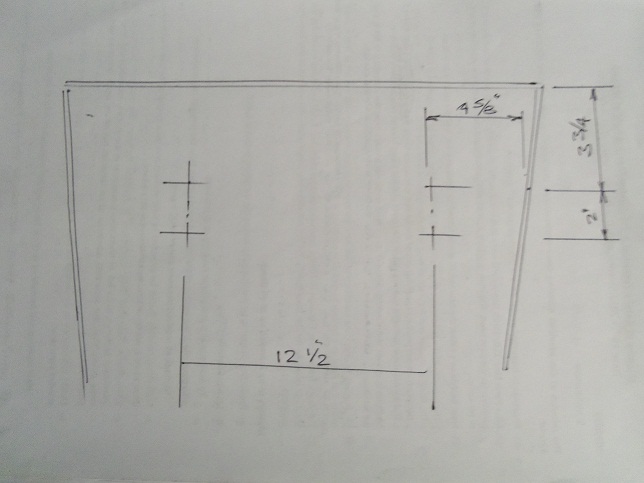

Hi Colin,
I can make you a sketch of the drilled holes in the subframe for the rack saddle bolts, but not the column suport bracket, I dont have one and will have to fabricate along with lots of other bits, including upper suspension arms as you gave me 2 left hand ones :roll: :roll: but if I fit the planned coilover shacks its probably a better solution :wink:

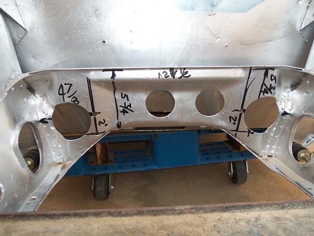

Hi Colin,
The rack holes in my subframe are not factory drilled and not accurate in their positions, ie approximate at best
Sat Jun 21, 2014 6:28 pm
Post Re: steering rack etc
Subframe
John, many thanks for those dims and drawing they will be most helpful. Also found some parts for your coupe in a bucket in the shed last week when I had a clear out. Seat belt supports and upper shock mounts. When are you in the UK next so I can get them to you?
