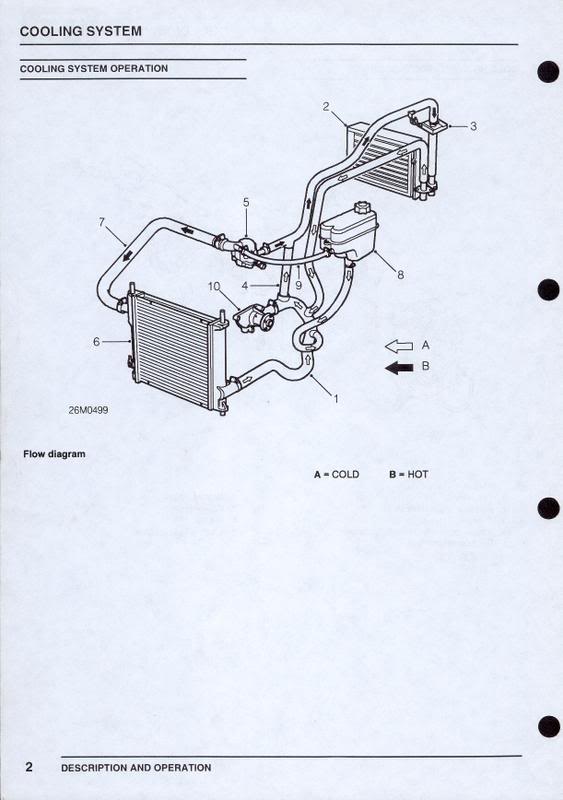

One of the things I would like to do to the car this year is to tidy and declutter the engine bay a bit. There seems to be a lot of pipe work going on in here. How easy is it to ditch the charcoal canisters? Does anyone have a simple coolant pipe diagram?

You've basically got an MPi cooling system like this:
