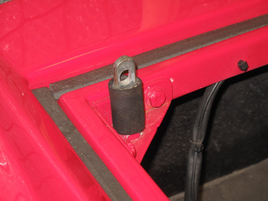

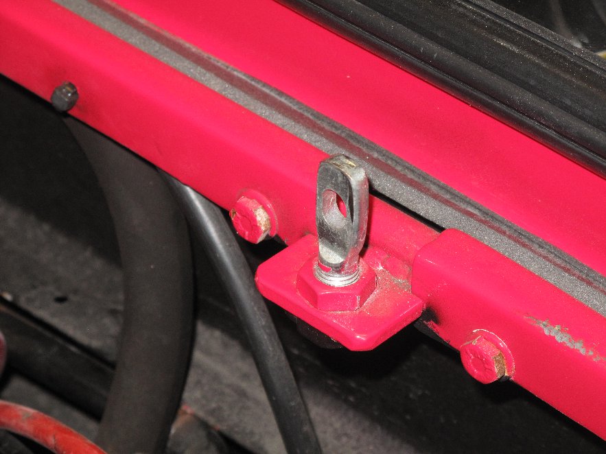

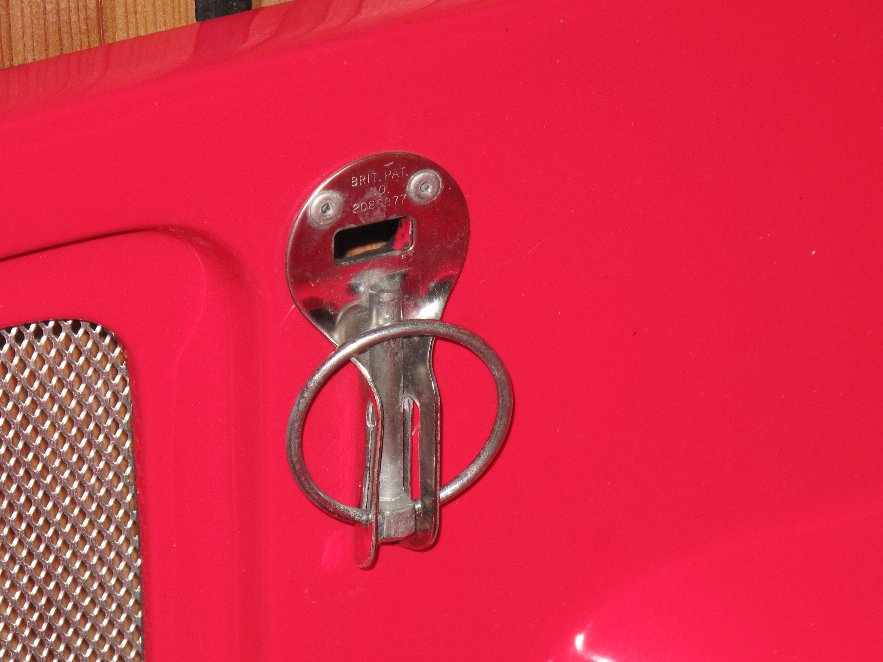

My thoughts on the bonnet issue which may or not be helpful.
It looks like your car has a two piece bonnet, wheras mine is one piece. A self adhesive foam strip has been run around the recess on the body in the bonnet opening. The bonnet has four latches and a bit of hose on the post for the pin sets the bonnet mounting height.
Martin
