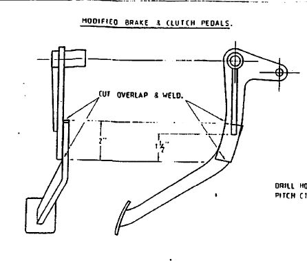

So far as I remember from when my Coupe was roadworthy, it had modified/shortened Mini clutch and brake pedals... modified in that they had been cut roughly half way along the thicker/wider part of the pedal arm, each half then overlapped to the required length and then seam welded... Made then slightly "heavier" in use due to reduced leverage etc., but put them at a more useable height from the floor.
I'm sure there's something in either the build manual or the GTMOC technical manual of a lot of years ago... I'll see if I can find it over the weekend if it'd help..
Yes that's right. Off the top of my head I reckon they were shortened by about 2".

This help ?
