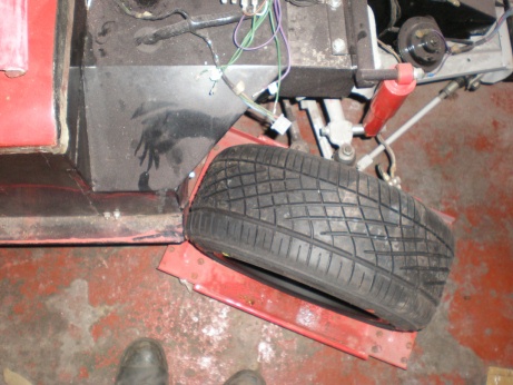

The offset of the wheel is also quite important.
I stuck with 13" wheels but they are 7" wide and have a large offset so fouled on the tub quite far before full lock.
This was fairly annoying as it meant cutting back and re-welding my already painted tub and then a respray on the entire sill and wheel well.
I reckon 14's and 15's is very possible but you would have to stay fairly thin with very little offset.
