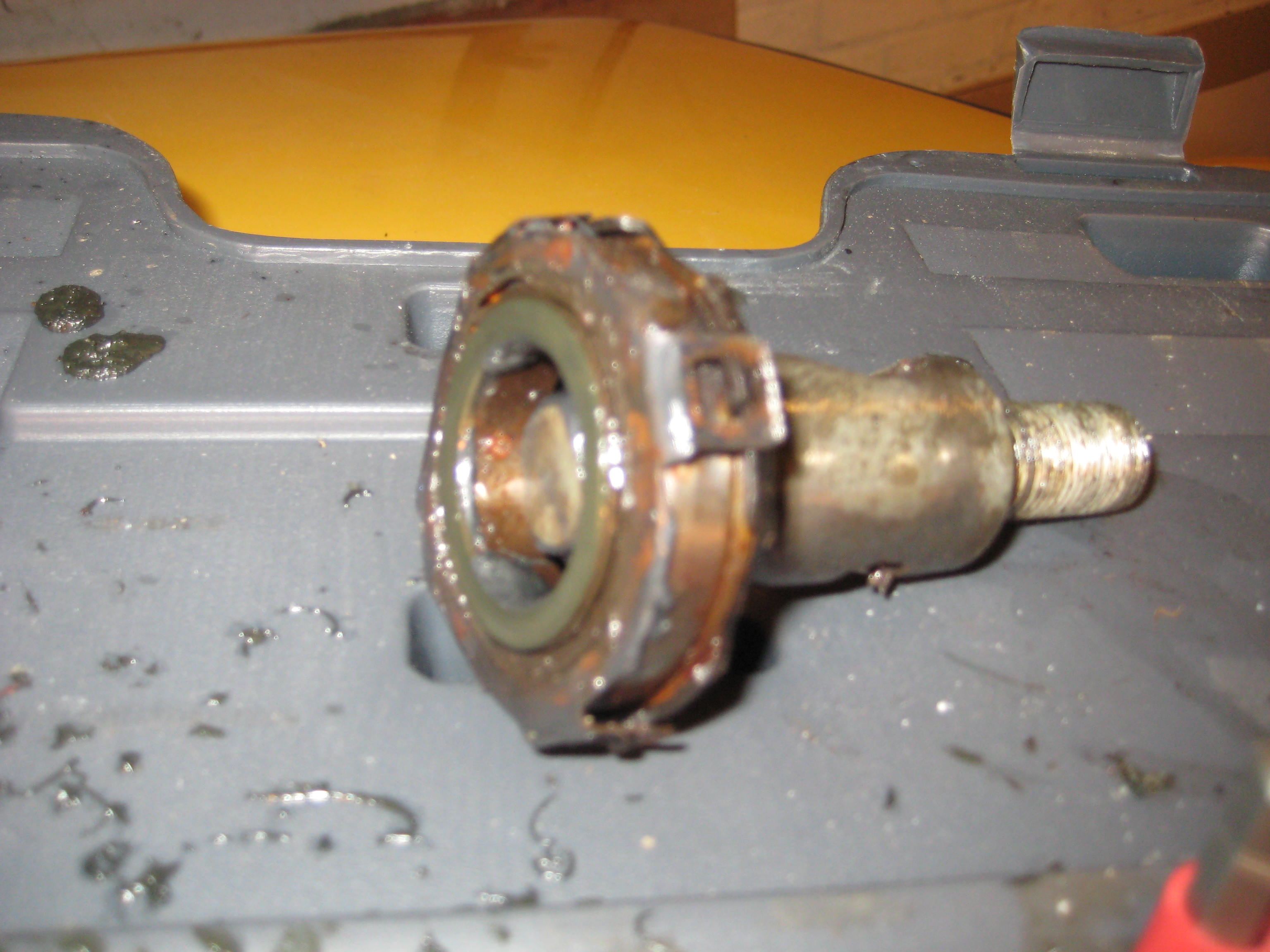

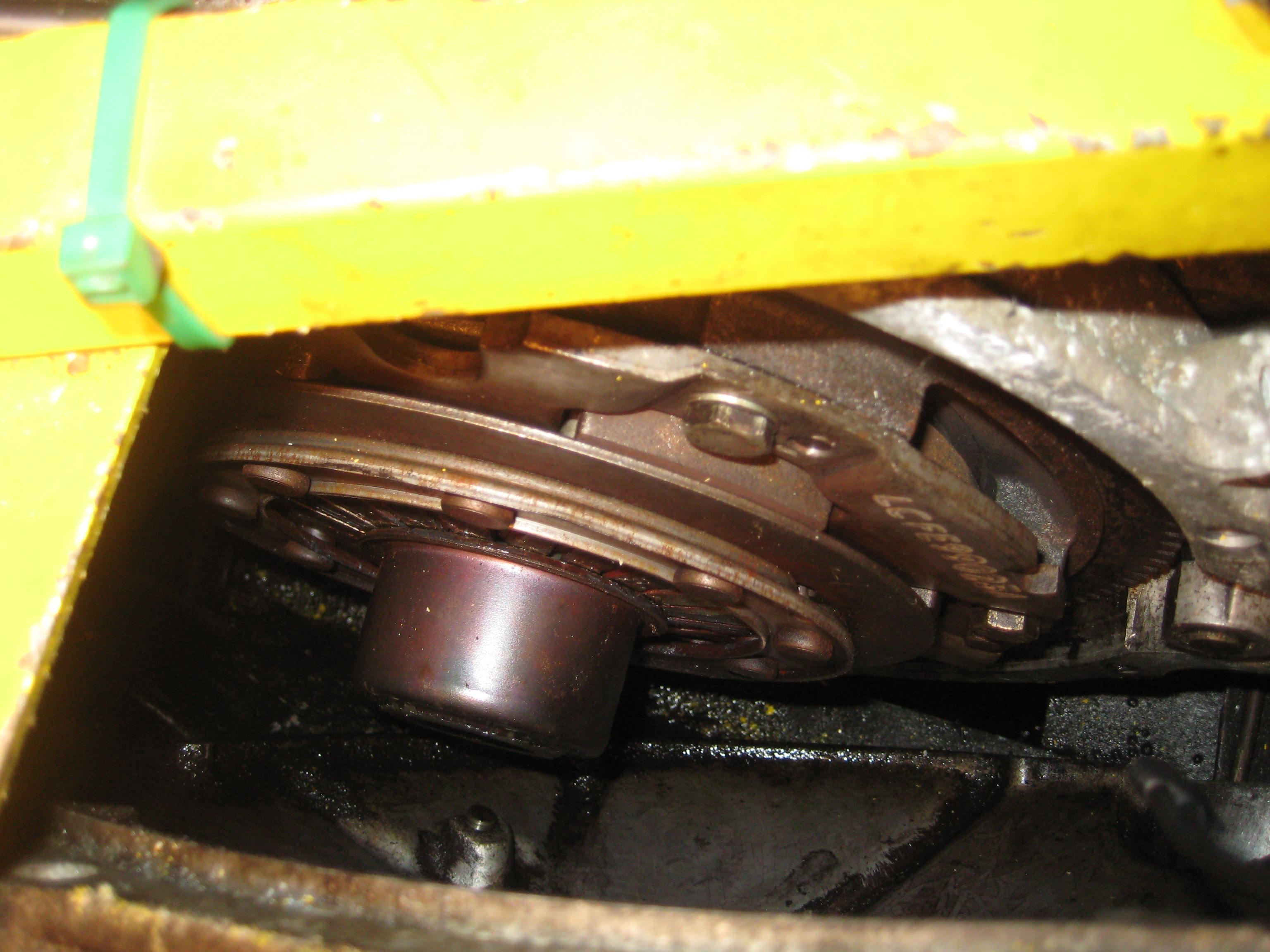

Right, I've got the wok off... Here are some pictures of what can be seen. I want to know if I need the verto release bearing and shorter arm etc to operate this setup. Can anyone identify the release bearing I have currently...?

That's a verto setup - so it should have the short arm etc.
It is a verto release bearing you have there.
