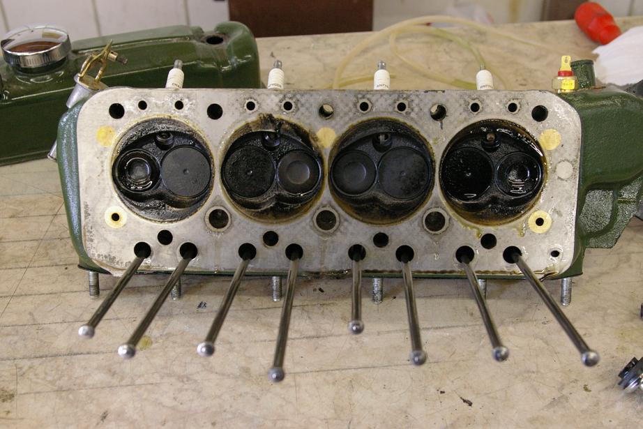

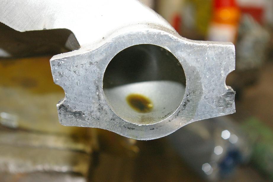

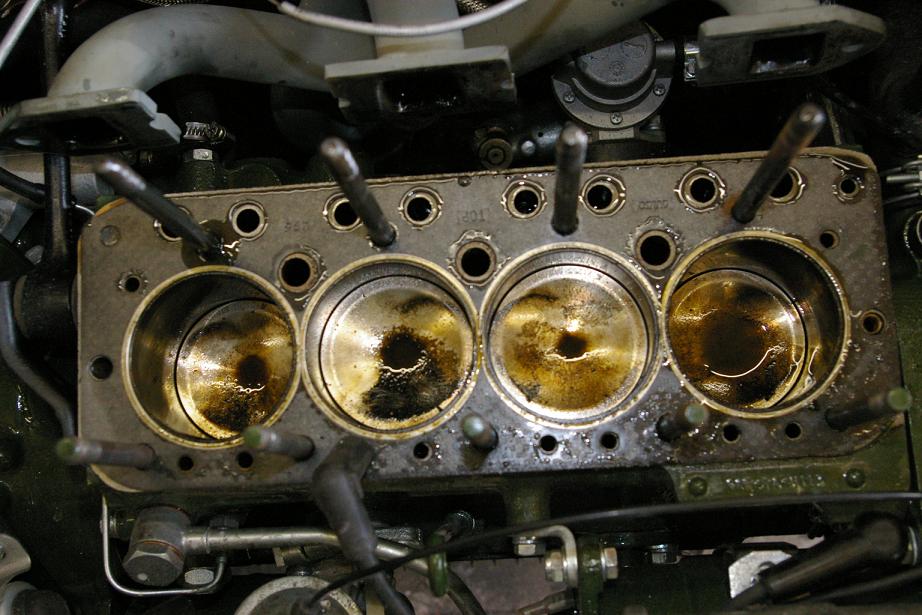

:D

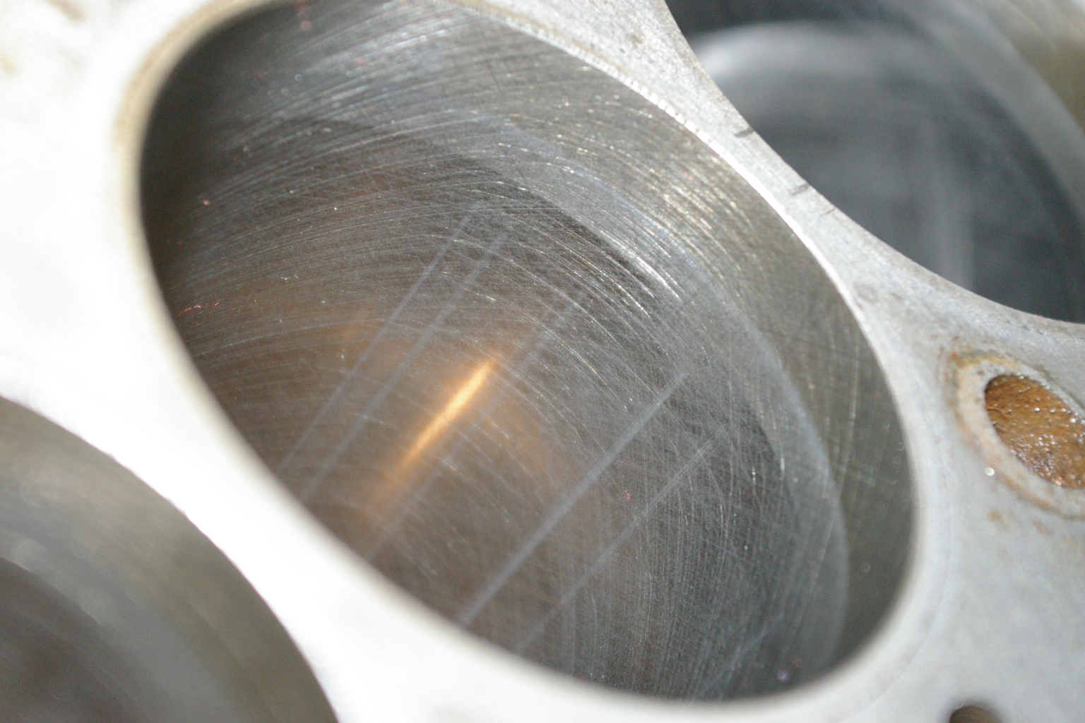

I have found theese marks on the cylinder.
Heat-seizing?

Post Re: 1275 grey smoke
Are there any corresponding marks, raised edges or anything on the piston?
By the look of those cylinder heads you are obviously burning massive amounts of oil.
If it's not coming up from the sump the only alternative is that it's coming down through the valve guides.
Mon Mar 01, 2010 4:02 pm
Posts: 363
Location: Ireland
If thats the honing then whoever did it needs to be shot
Yes. But what's causing the vertical marks after such a short running time?
