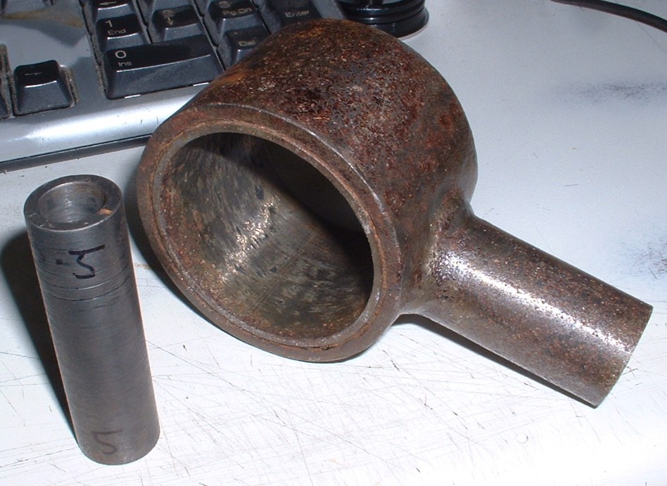

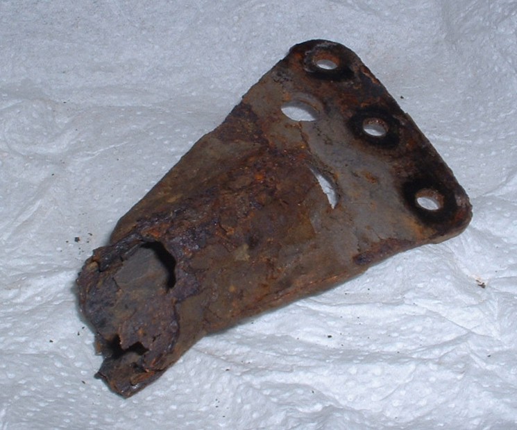

FYI my bar has failed at the front end, the tube has fatigued/rusted until it broke - by the look of it. Also the flat plate that goes under the car you can see where the metal has thinned, presumably also from flexing and the build up of rust flaking off bit by bit. The hollow tube is open at the front, allowing water etc in - not ideal methinks. I'll post pics probably.
This after 16 years of year round use - check your steady bars chaps!
I intend to use the rear end bush metalwork and original sump bracket which are still ok. I've removed the old rubber & metal crush tube out of the bush and will redo this with some polyurethane rubber shore A60. The tube I might use a bit of stainless instead, with threaded ends going into the old bush housing. The front I am thinking of making some sort of flexible joint fixed to a (similar to the original shape) stainless plate.

Pics

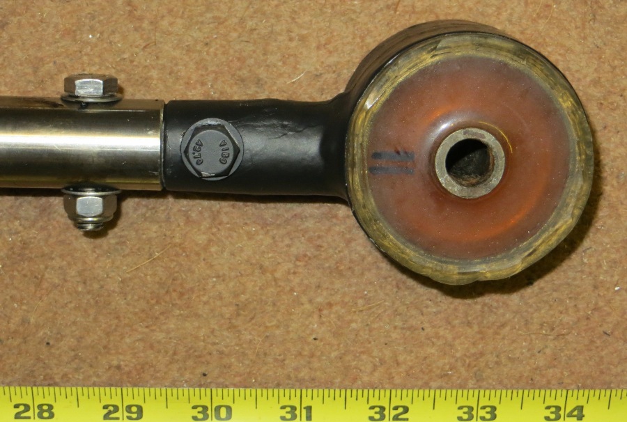

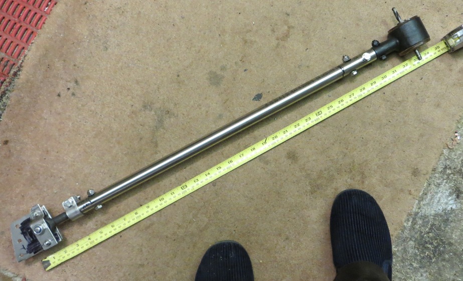

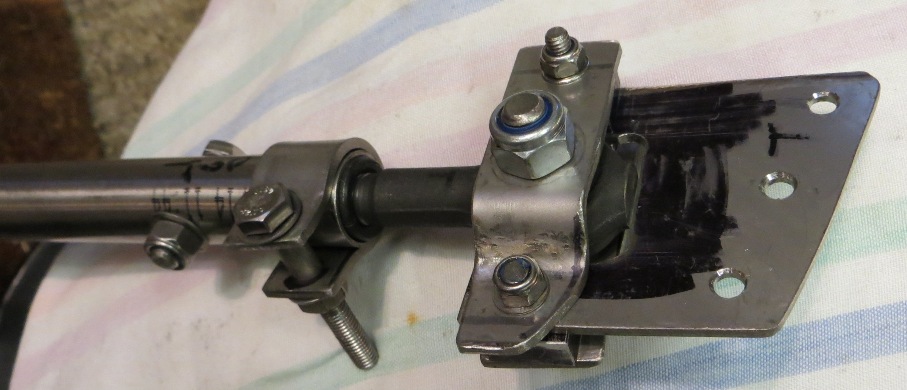

New steady bar made up, mostly out of stainless steel. For rear joint, made top hat poly bushes using shore A60 polyurethane, retained original steel outer and crush tube. Front joint is a solid rubber 'rose joint' type off a VW #131415813E with the ball joint cut off.
Has now been fitted to car and looks/feels ok. Not run engine or driven it yet.

I reused the original GTM four bolt mount plate/long bolt that goes on the sump, as they were perfectly fine, not bent at all. (slippers not mine :D )
WEST - the 'head' dia of the VW part is about 36mm, the through bolt is a 10mm and the crush tube it goes through's length is about 24mm. The threaded end is a M14x1.5 Left hand. Ebay item # 222036129258 was about £11. Use threaded inserts ebay # 171302211775 to fix it inside the tube.
I used the VW part cos I wanted a simple robust rubber bushed type (rather than eg. a rose joint) at the front end to allow for any movement there as its quite clear the old steady bar was flexing slightly at that end. The VW part was the best I could find of the right sort of thing in the right size and was cheapish.
